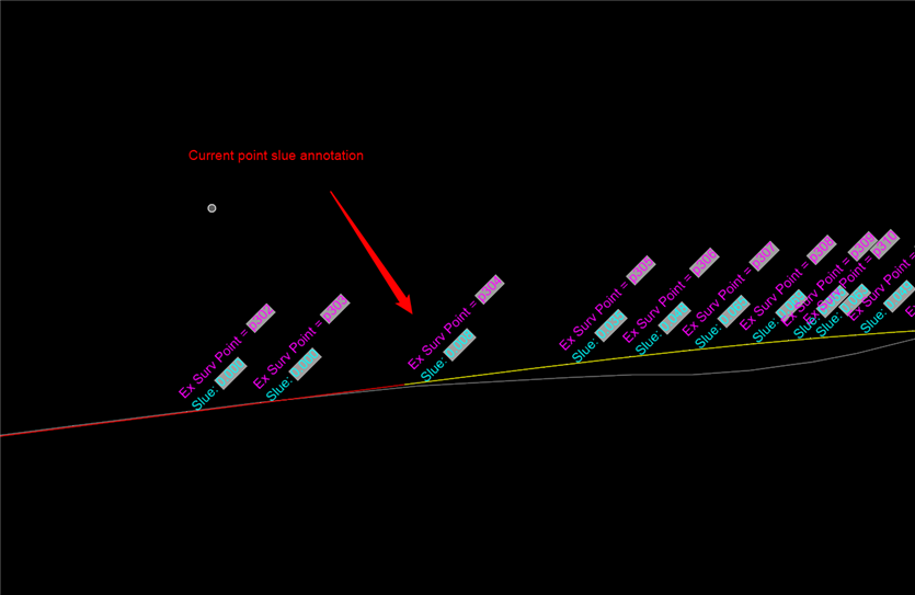

Question:

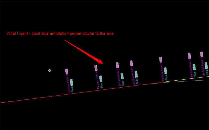

I created geometry from regression analysis. I would like to show slue annotation on the plan. Is it possible to set the point slue annotation to be displayed perpendicular to the axis?
Answer:
The video below shows how to achieve this effect. You need to change the rotation of the points relative to the axis. The "Modify Points" tool will be helpful.
