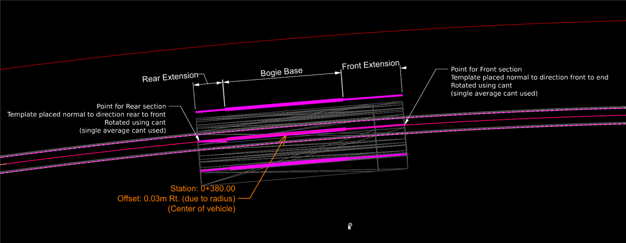

Coach Definition
Rolling stock may be defined in two ways.
Simplified method assumes rectangular shape of rolling stock section (“Longitudinal and rectangle”) more advanced method (“Longitudinal and template”) uses custom rolling stock section.
In order to define 3D model of rolling stock apart of section definition, location of bogies (“Bogie Base”) and front and rear extend of rolling stock from bogie location are necessary.
“Longitudinal and rectangle” method requires also elevation of rectangular rolling stock section above rails.
In “Longitudinal and template” method elevation is derived from rolling stock section definition.

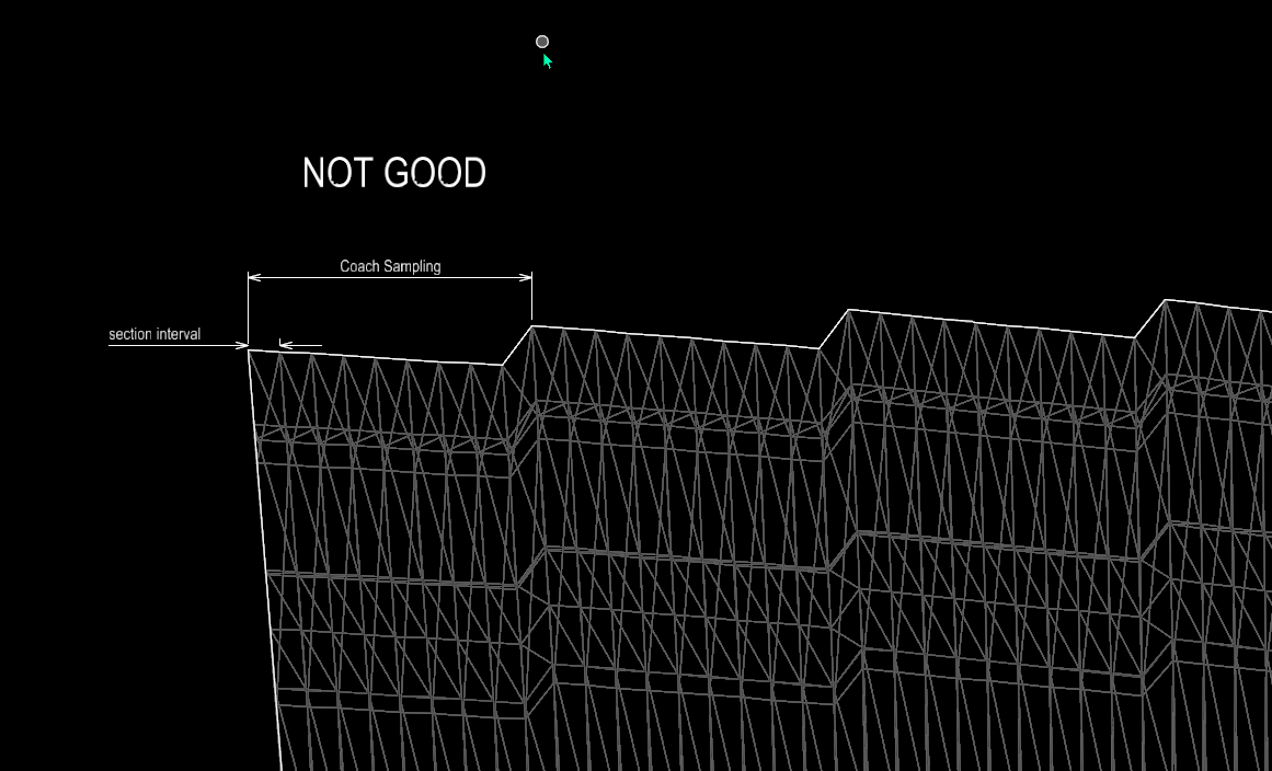

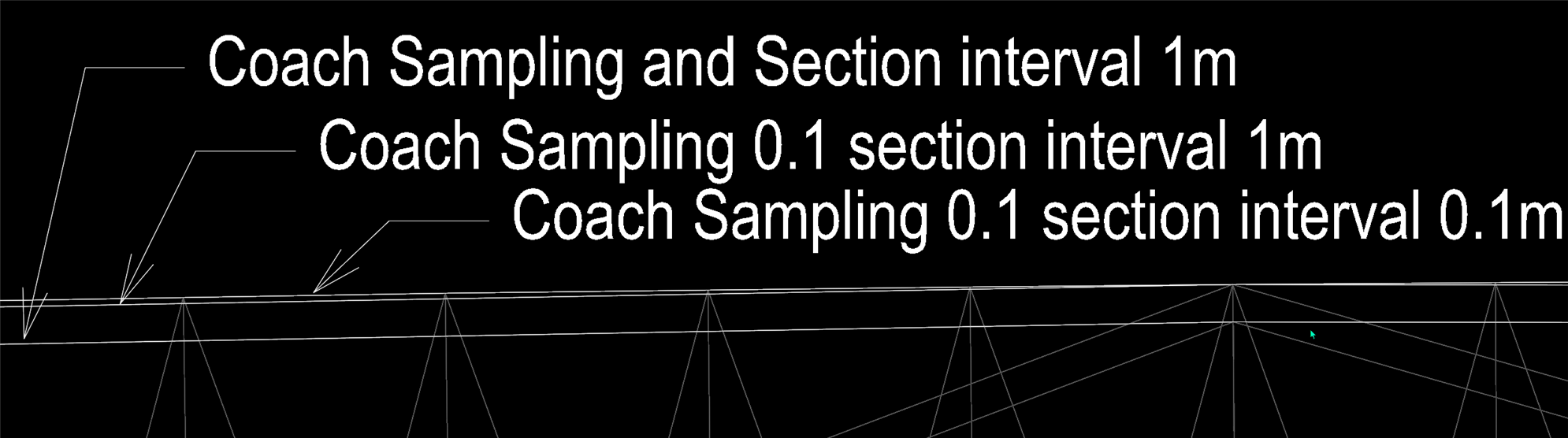

“Section Interval” (or “Section Sampling”) defines distance between consecutive locations where sections used for generation mesh representing swept extent are generated.
“Coach Sampling” defines locations used for placement of rolling stock used to generate individual mesh sections.
Section interval must always be greater than coach sampling interval.
Example below where coach sampling in x10 section interval. 10 sections are calculated where the coach is not "moving", then new position of coach is defined. That is why we have steps.
Decreasing coach sampling value increases accuracy at each section interval.
Increasing section interval decreases the size of the mesh but decreases accuracy between section interval because it is a straight between section intervals.
