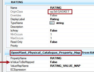

Reason for this error is that Rating value for FLANGE, BOLT and GASKET in spec is written as CL150. But in schemas, CL150 is mapped to 150LB in RATING_VALUE_MAP class and because of this software tries to find 150LB rating in specs which it doesn't find and hence fails. Below is the snapshot for RATING_VALUE_MAP class.
Steps to Resolve
Instead of using the value map, pick the rating values directly from specs for FLANGE, BOLT and GASKET. Below are the steps to do that.
  1. Launch Class Editor and load OpenPlant_3D schema from your project. This schema is generally located in C:\ProgramData\Bentley\OpenPlantModeler V8i\WorkSpace\Projects\OPModeler_Imperial\DataSet\Schemas.
  2. Supplement it with OpenPlant_3D_Supplemental_Modeling schema.
  3. Go to PIPING_COMPONENT class and select RATING property.
  4. Locate OpenPlant_Physical_Catalogue_Property_Map custom attribute and change "IsValueToBeMapped" to False.
  5. Now go to BOLT class and select RATING property.
  6. Locate OpenPlant_Physical_Catalogue_Property_Map custom attribute and change "IsValueToBeMapped" to False.
  7. Similarly, make the same change for RATING property on GASKET class.
  8. Save the changes and verify the result.
