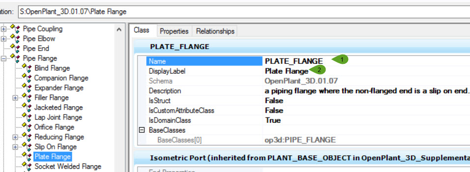

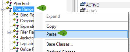

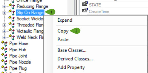

  2. Navigate to Slip On Flange class. Right click to Copy it.
  3. Paste it on PIPE_FLANGE class.
  4. Rename it as desired, say PLATE_FLANGE. See image below.
  5. Copying Classes would benefit to add other related custom attributes and properties automatically. This will also include the custom attribute from supplemented schema.

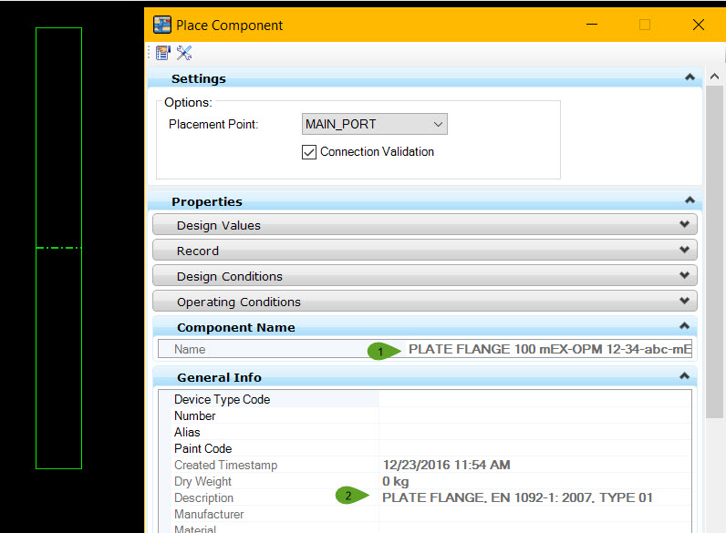

  9. Launch OpenPlant Modeler & Verify results.

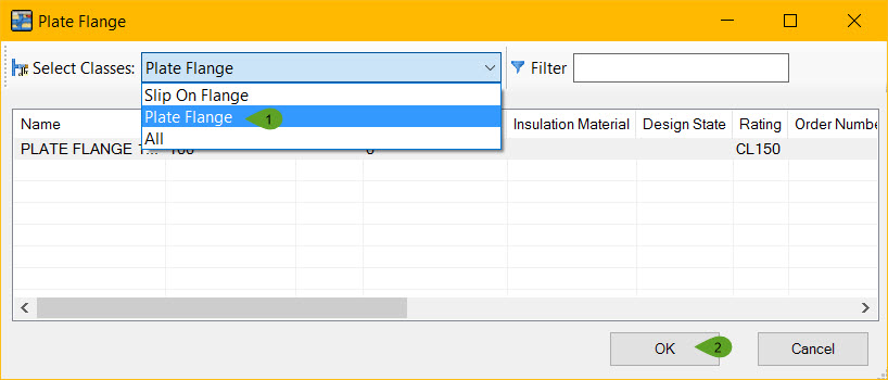

  10. Click on Flange. Select plate flange from dialog box. The drop down option activated because of custom attribute used in step 6 above.

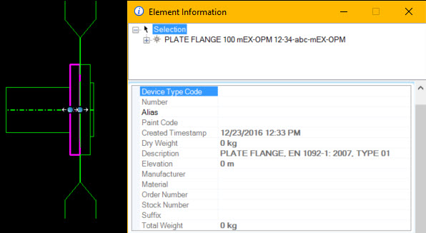

  11. Check details.

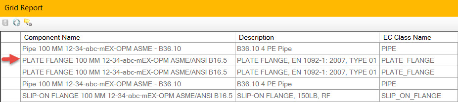

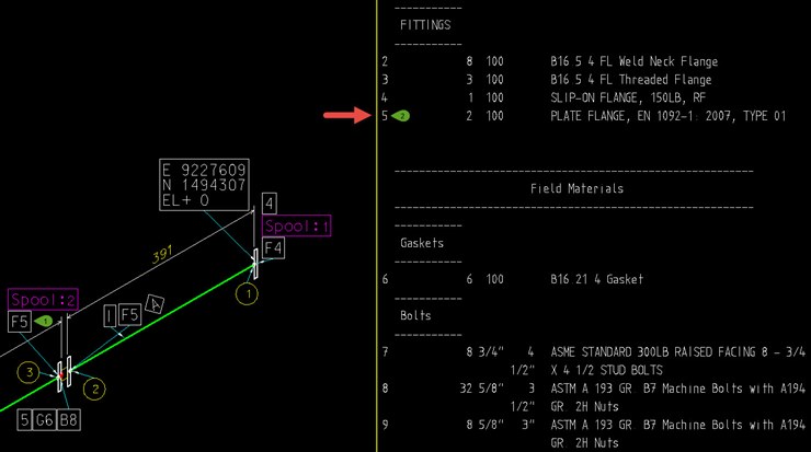

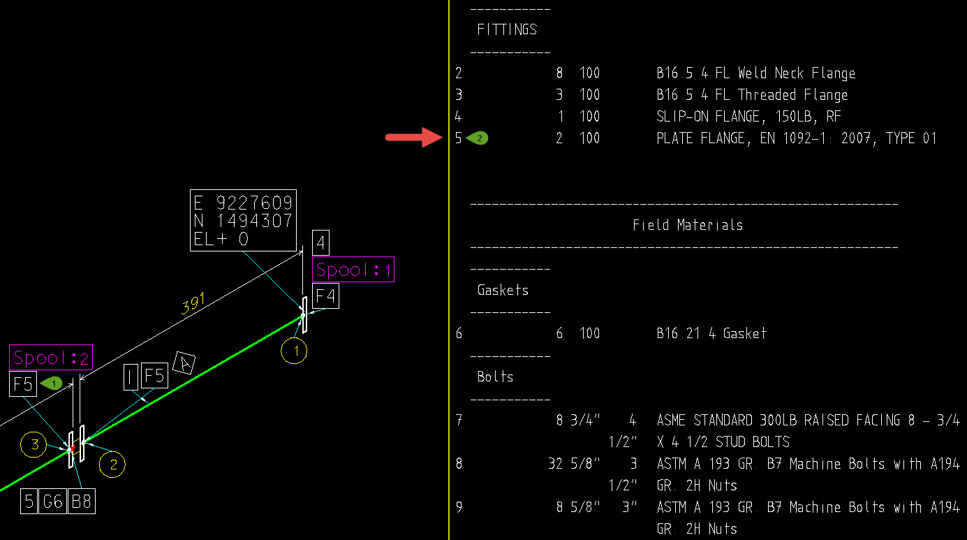

  12. Check output in OpenPlant Isometrics Manager.

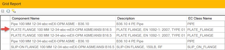

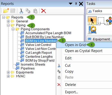

  13. Check output in DGN Reporting. BOM by Line Number, in a grid view.
