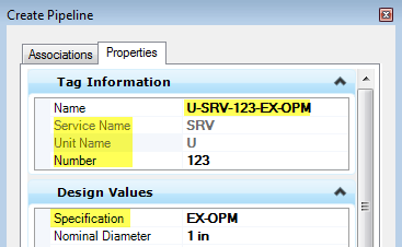

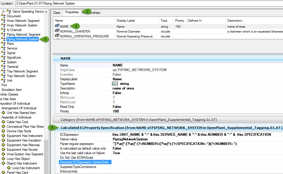

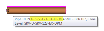

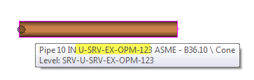

To Modify Pipeline Tag Name as per project tagging nomenclature in OpenPlant Modeler.

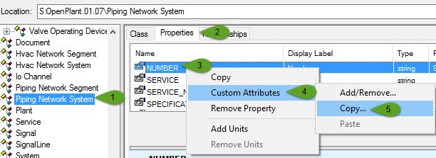

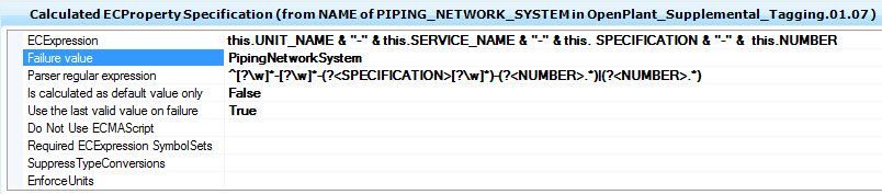

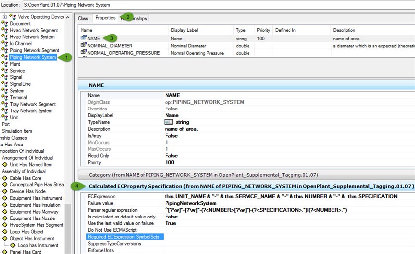

User requirement was to modify the Pipeline tag Name as per project requirement. By default OpenPlant Modeler pipeline tag contains UNIT-SERVICE-NUMBER-SPEC.

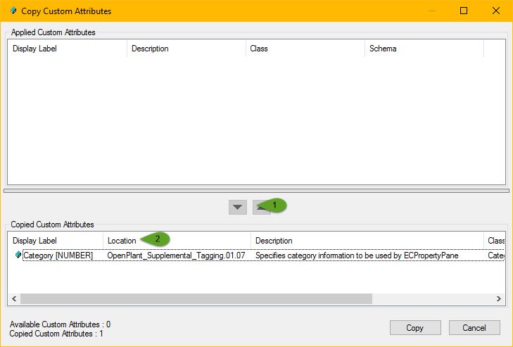

New Pipeline tags was required to have the nomenclature as UNIT-SERVICE-SPEC-NUMBER. Below steps illustrates on modifying tagging for a pipeline in OpenPlant Modeler.

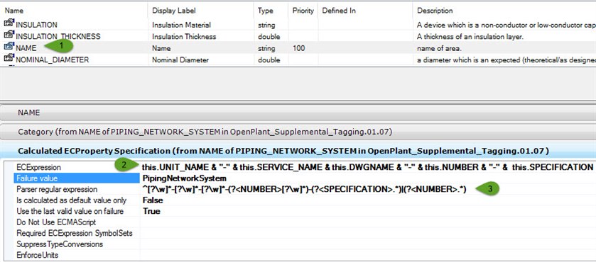

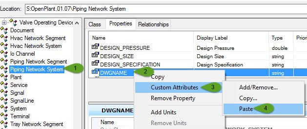

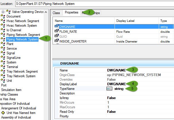

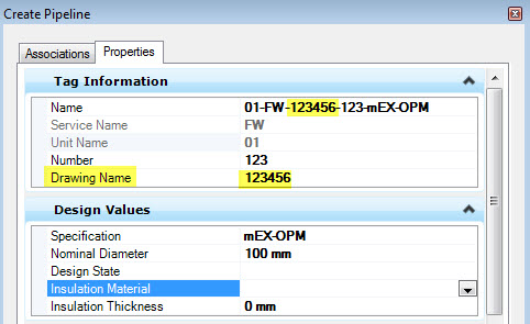

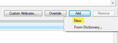

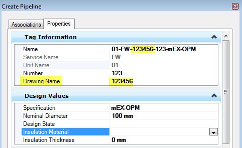

Sometimes it may require to add a new Property in addition to Existing pipeline tag, which contains UNIT-SERVICE-DWGNAME-NUMBER-SPEC. User need to create a new property "DWGNAME" and need to assign it under category "Tag Information". See below steps to achieve it.
