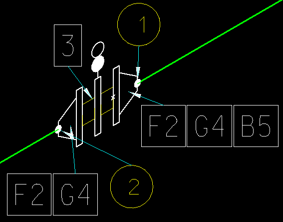

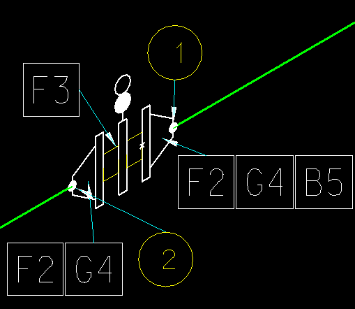

In OpenPlant Isometrics Manager, user wants to remove PartID prefix for spectacle blind. Currently in generated isometrics spectacle blinds shows prefix as shown below.
Here requirement is to remove prefix “F” & only to show number for spectacle blind.

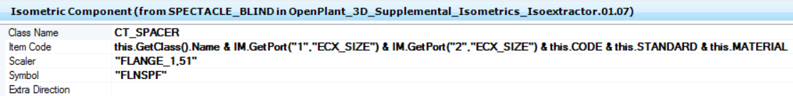

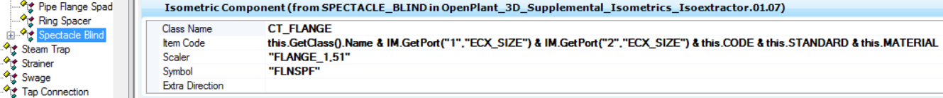

  3. Navigate to Spectacle Blind class, search Isometric Component custom attribute as shown below.
  4. Change Class Name from CT_FLANGE to CT_SPACER as shown below.
    Class Name = CT_SPACER
  5. Save all the changes & verify the results as shown below.
