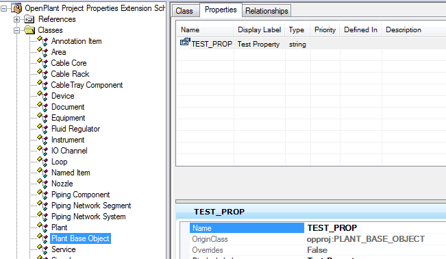

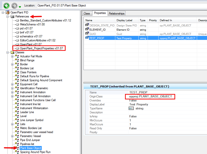

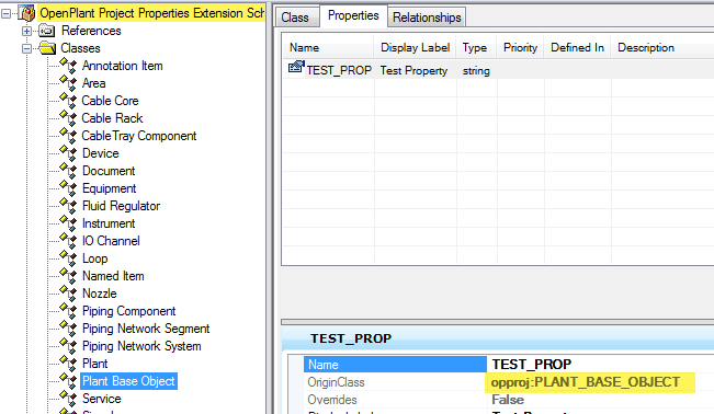

User added all his custom properties in OpenPlant_ProjectProperties.01.07 schema and want to see all these properties in class editor by loading only OpenPlant_PID.01.07 schema. Currently, it shows the properties and classes of OpenPlant.01.07 schema its own classes and properties. For this example, a test property is added in PLANT_BASE_OBJECT class of OpenPlant_ProjectProperties.01.07 schema as shown below.

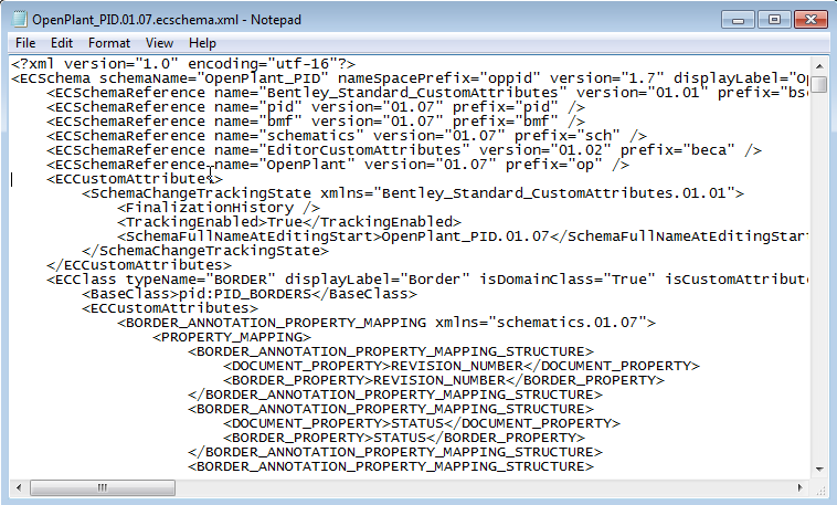

  1. Open OpenPlant_PID.01.07 schema in notepad. This schema is located in C:\ProgramData\Bentley\OpenPlantPID (SS6)\WorkSpace\Projects\%PROJECT%\Dataset\schemas folder.

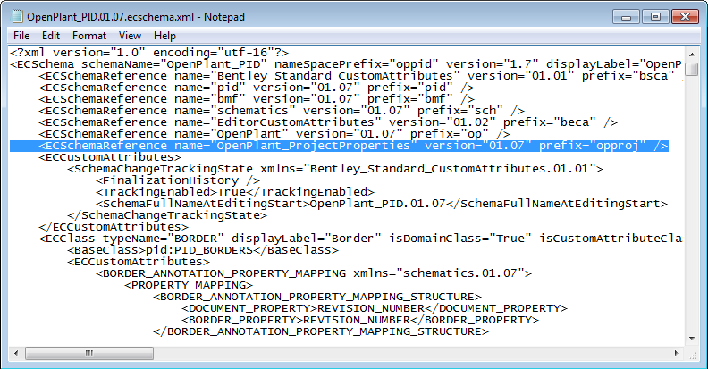

  2. Add below line in the schema in references section as shown in the picture below.
        <ECSchemaReference name="OpenPlant_ProjectProperties" version="01.07" prefix="opproj" />

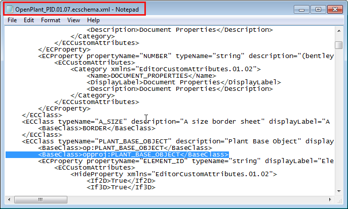

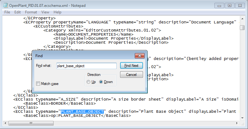

  3. Find PLANT_BASE_OBJECT class in OpenPlant_PID.01.07 schema in notepad.
  4. Add below line to add base class in PLANT_BASE_OBJECT.
            <BaseClass>opproj:PLANT_BASE_OBJECT</BaseClass>

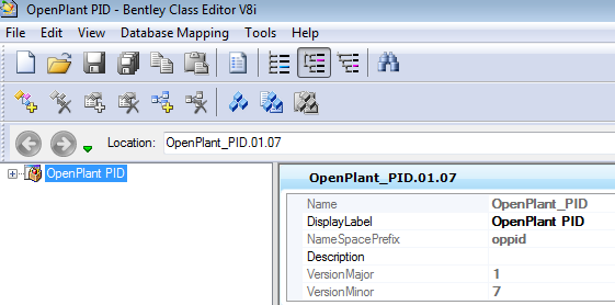

  5. Save the changes and load OpenPlant_PID.01.07 schema in class editor.
  6. You will see the property in the schema without opening OpenPlant_ProjectProperties.01.07 schema.
