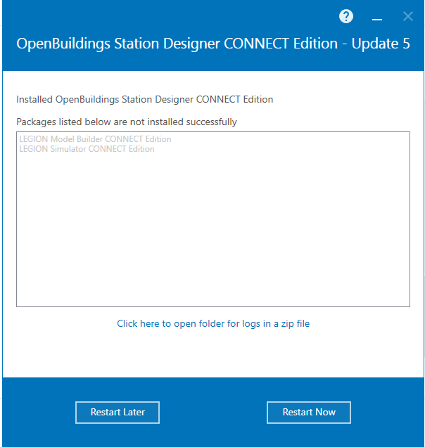

Cannot successfully install LEGION from the OpenBuildings Station Designer installer
 Product(s):LEGION
 Version(s):CONNECT Edition
 Environment:N/A
 Area:Installation
 Subarea:N/A
Problem Description
When trying to install OpenBuildings Station Designer, LEGION Model Builder and Simulator failed to install.
It seems that this could be a Microsoft C++ 2017 redistributable issue. It looks as if Microsoft C++ 2017 redistributable had affected the 2015 redistributable required by LEGION, so this couldn't support LEGION installations.
Below are the steps to resolve the error
1. Uninstall Microsoft C++ 2017 redistributable 14.16.27012
2. Re-install Microsoft C++ 2015 redistributable
3. Install LEGION Model Builder and LEGION Simulator
4. Re-install the following version of  Microsoft C++ 2017 redistributable 14.01.25017.0
