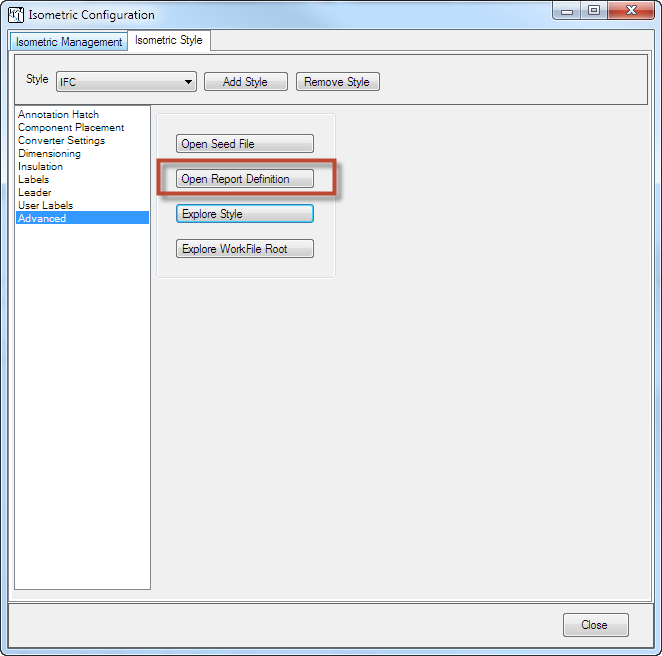

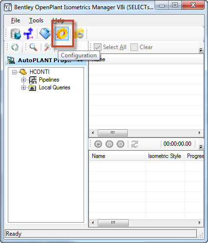

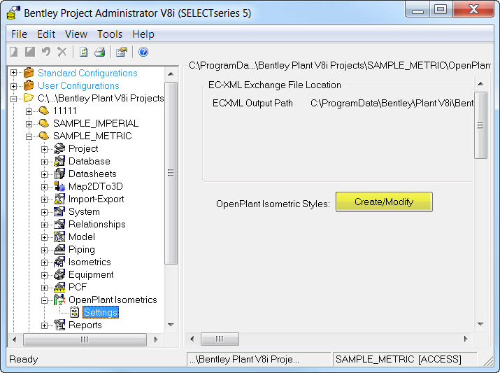

Extraction of Bill of material can be customized. It will make it easier for the user to extract the report from isometrics Bill of Material/Quantity report and to generate CSV file thus providing flexibility to use. It can be experienced using both OpenPlant modeler and AutoPLANT Modeler. This has been shown in context with AutoPLANT Modeler and OpenPlant Isometrics Manager. However similar approach could be utilized for OpenPlant Modeler and OpenPlant Isometrics Manager.
# A sample report that writes a CSV file
REPORT = CSV
# this to exclude welds
EXCLUDE = IE_TYPE=CT_WELD
COLUMN = 3: R : PARTID
COLUMN = 19: R : QUANTITY
COLUMN = 7: R : SIZE1
COLUMN = 7: R : SIZE2
COLUMN = 60: W : "\"" + IE_DESCRIPT + "\""
GROUP = PARTID
SORT = PARTID:N
SEP = ,
TEXT = @PARTID,QUANTITY,SIZE1,SIZE2,"DESCRIPT"
Write =
END
