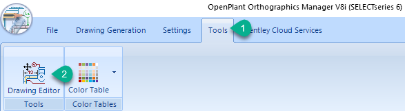

  1. Launch OpenPlant Orthographic Manager and select a project.
  2. Go to Tools tab and select Drawing Editor. Refer below image.

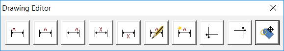

  3. Selecting Drawing Editor command, will show Drawing Editor tools as shown below.
  4. Select last tool icon from drawing editor tools that is "Move Tag" command as shown below.

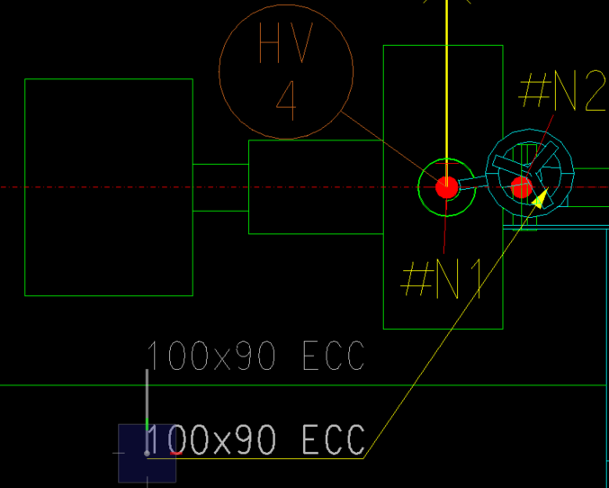

  5. Select drawing tag in generated orthographic drawing & move to new desired location as shown below.
  6. Enter a data point (left mouse click) to finish the command.
