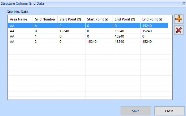

  3. Selecting Structural Column Grid tool will pop-up window as shown below.

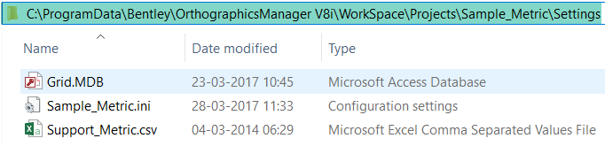

  4. Click on "+" symbol and add start points & end points to enter points & click on Save. Saving this will automatically create a Grid.mdb in Settings folder of project as shown below.

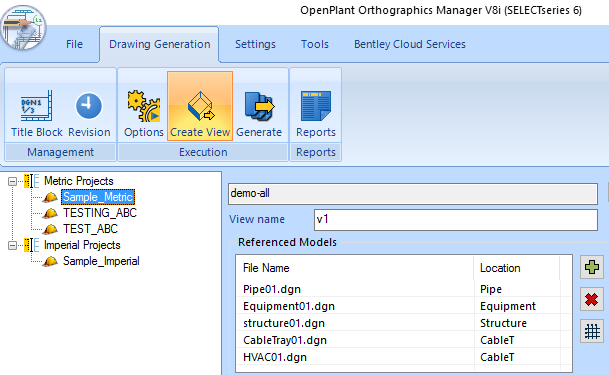

  5. From Create View, create your desired view & add respective referenced model files of different disciplines as shown below.

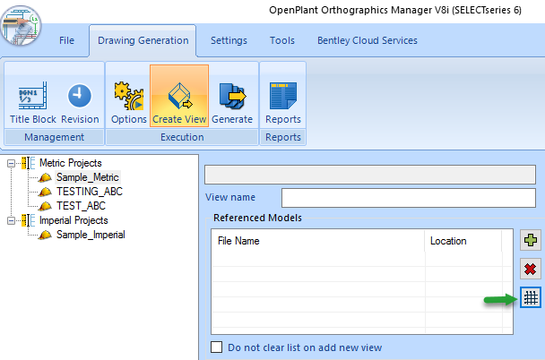

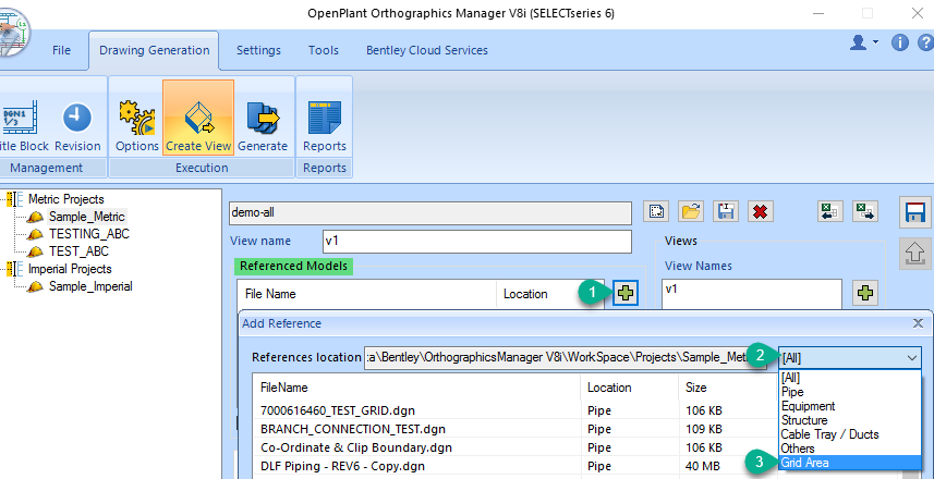

  6.  As far, we have not added our created Grid.MDB file. To add this, click on Add a reference Model.

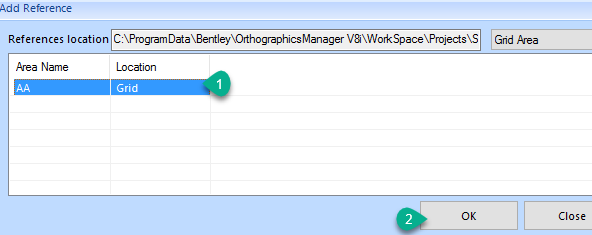

  7. From Add Reference dialog, click on All & select Grid Area as shown below.
  8. Select your defined Grid Area name AA, click OK as shown below

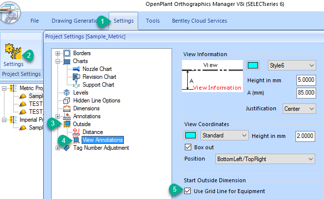

  9. Navigate to Settings tab, select Settings > Outside > View Annotations & check Use Grid Line for Equipment option as shown below.

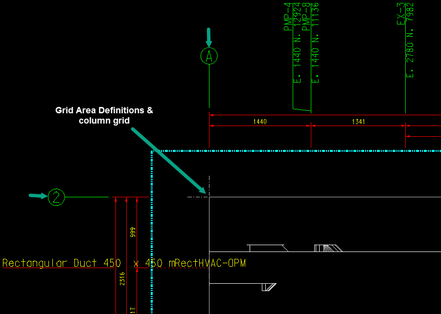

  11. Define 3D Clipping Area & View Output Position for the referenced model files & generate drawing to verify the result as shown below.
  12. Also, notice that equipment dimension is done w.r.t structural column grid definition.
