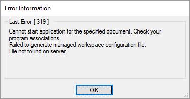

"[Error 319] Cannot Start Application for the Specified Document" on Opening the File from Projectwi
Product(s):OpenPlant Modeler
Version(s):08.11.09.XXX (SS5) | 08.11.11.XXX (SS6)
Area: ProjectWise
Subarea:
Original Author:Harpreet Singh, Bentley Product Advantage Group
Problem Description
Sometimes below error appears while opening a file from ProjectWise Explorer. This happens when you are launching OpenPlant Modeler in managed workspace environment.
Steps to Resolve
  1. Reason for above error could be that a file within the workspace has gone corrupt. If you see any file in the workspace folders which shows 0KB size, delete that file and replace it with the correct file.
  2. Check the associations of the file which you are trying to open.
  3. Check the projectwise log (Pwc.log) file which is located in C:\Users\%User%\AppData\Local\Bentley\Logs folder which will help you identify the erroneous file.
Still a Problem?
If above problem still persist, then please create a Service Request and contact Bentley Product Advantage group along with the list of all relevant details to get in depth analysis and for possible solution or workarounds.
