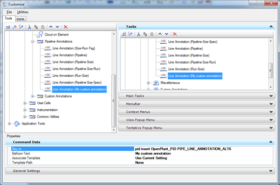

Add your newly created annotation to user tools for a quick reference
- Open PIDProjectSymbols.dgnlib file from your %project%\Dataset\dgnlibs\ folder
- In the top menu select Workspace->Customize
- Browse to the desired place (User Tools->Annotation->Pipeline Annotations)
- Copy one of the existing tools to easily modify it;
- Change the name and Key-in of the tool ("pid insert OpenPlant_PID PIPE_LINE_ANNOTATION_ALT6")
- Copy this tool to Tasks as well;
- Save and close the dgnlib file. Restart OPPID.
