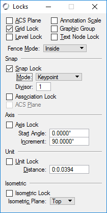

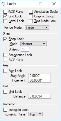

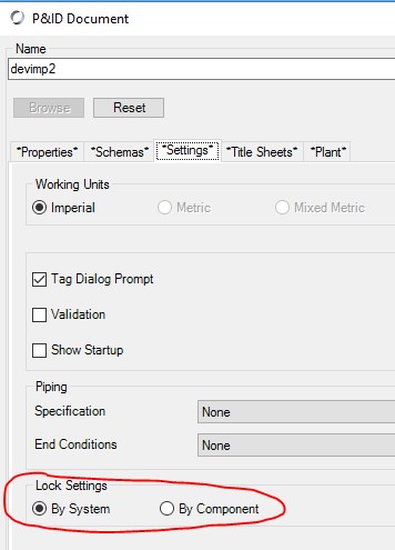

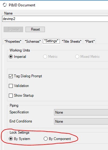

Placement snap is dictated by Lock Settings
Values from this drawing settings dialog are saved in user config file, not the projects pcf file,
making this a workstation setting, not a project based setting
If changed to By Comp, uses custom attributes to determine what type of settings for comp being placed.
As an example, a valve’s default comp snap is Nearest, with grid off.  Probably reducer also.

Note: with System values
With Nearest, it ignores grid.
With Keypoint it doesn’t ignore grid
