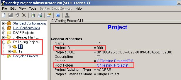

Project Root | C:\Testing Projects |
Project ID | 0001 |

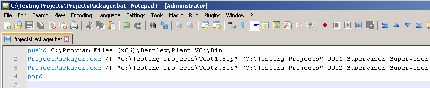

- Create *.bat file with commands in it to package required AutoPLANT projects:
pushd C:\Program Files (x86)\Bentley\Plant V8i\Bin
ProjectPackager.exe /P "C:\Testing Projects\Test1.zip" "C:\Testing Projects" 0001 Supervisor Supervisor
ProjectPackager.exe /P "C:\Testing Projects\Test2.zip" "C:\Testing Projects" 0002 Supervisor Supervisor
popd

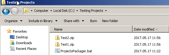

- Open CMD and type in batch file running command:
C:\Testing Projects\ProjectsPackager.bat
If path contains directories with spaces in their names, then you might get same message. In this case a short path can be used instead. To check what Short path name is for required directory open CMD, go to required directory and with dir/x command populate information about all directories
cd C:\
dir/x
In this example Short path name isTESTIN~1
C:\TESTIN~1\ProjectsPackager.bat
- After launching this batch file all defined projects will be packaged one by one without need of going trough Project packaging wizard.
