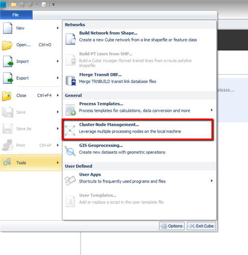

1. Using Cluster Node Management tool
The cluster node management tool is available with the standard Cube Base installation. This tool can be opened from ‘File>>Tools>>Cluster Node Management’

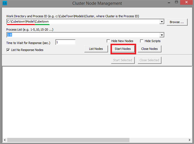

The ‘Work Directory’ and ‘ProcessID’ field should contain the location of the cluster work directory followed by the process ID. The process list field should contain the list of cluster nodes to start on this physical machine. Click ‘Start Nodes’ to start the Cluster slave nodes. In the below example, we are starting 8 Cluster nodes (numbered from 1 to 8) with process ID, ‘Cubetown’ and work directory ‘C:\Cubetown\Model\’
For setting up cluster nodes across multiple machines, the same process will be followed on each machine with different sequence of process list numbers on different machines. For example, for two machines with 8 cores each, the user can start Cluster slave nodes 1 to 8 on one machine and 9-16 on another machine. The same node numbers (for the same process ID) should not be used across machines. Also, the work directory should be a shared location where all the machines have access to read and write files.
