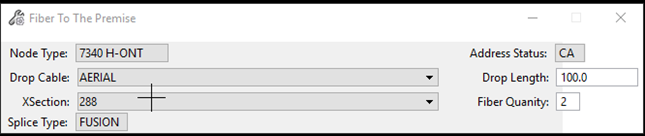

The Place FTTP command automatically places a network interface device (NID) on each address found within the FTTP boundary and places a drop cable from that NID to the associated network access point (NAP). When selecting the Place FTTP dropdown in the Placement section of the Fiber tab, the following commands will be available:
Clicking the Place FTTP icon will open the Fiber To The Premise dialog which allows the user to define the NID (node) type, the drop cable, XSection, etc. of the drops which are placed while designing with this utility:
  1. Select a Node Type. This device, usually called a NID, is placed on the side of the home for each address.
  2. Select a Drop Cable & Length. The drop is placed between the NID and the NAP.
  3. Select an Address Status.
  4. Select a Xsection to be used with fiber cables.
  5. Select the Splice Type used to connect the NID and NAP.
  6. Select the Fiber Quantity needed to feed each NID.
  7. Select the boundary to execute the FTTP fiber design procedure.
NOTE: The FTTP Utility requires the following 8 conditions be met:
1.)  Link to strand must be on.
2.)  Addresses must be linked to the housecounts.
3.)  Housecounts must be linked to the poles/peds or enclosures.
      (When using Duct, housecounts and addresses have to be manually placed. Enclosures act as poles/peds.)
4.)  The NAP must have capacity for the number of addresses it is feeding.
5.)  There must be an existing ‘FTTP boundary’.
6.)  There must be a cabinet placed anywhere within the boundary.
       (Drops will be drawn but not connected to the NAP if no cabinet is found in the boundary.)
7.)  There must be fibers dropped off at each NAP (1 fiber for each drop to be drawn) and all fibers must be connected all the way back from the Cabinet for the drops to be drawn.
8.)  Addresses must already be posted before running the FTTP utility.
 If no drops were drawn from the NAP to the NIDs in the FTTP module, and the following error displays:
                                      ‘No drops processed due to lack of capacity’
…Open the fiber specfile and go to the Fiber Splice Enclosures and make sure that each splice being used as a NAP has the ‘NAP’ checkbox checked, in the spec file definition for that splice. (Create a NAP4, a NAP8, NAP12 etc. and you will have the correct NAP to lay out for the exact number of addresses that will be connected).
 NOTE: A designer CAN use NAPs with a defined capacity larger than the number of addresses it is feeding, but NOT a NAP with a defined capacity of LESS than the number of addresses it feeds.

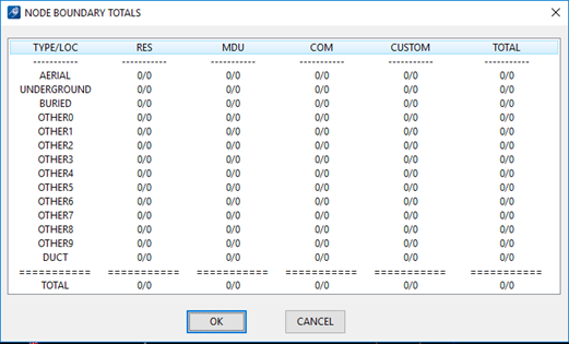

 Place FTTP Boundary
The FTTP Boundary command defines the service area by polygon for a specific LCC (Local Convergence Cabinet). The command also calculates and reports the number and type of addresses being serviced within that area (residential, commercial, MDU).
 Select the Place FTTP Boundary command and the following dialog opens.
  1. Select Edit Existing Boundary in the dialog box and select an FTTP boundary on the map.
  2. If needed, edit the FTTP boundary name displayed in the dialog box.
  3. Modify or add vertex(es) to the boundary.
  4. Click the right mouse button to complete.
  5. The Node Boundary Totals dialog box opens.
The dialog box displays the total number of house counts found in the boundary. Click OK to save the modification made on the boundary.
Create a new FTTP Boundary
Select the Create New Boundary command:
  1. Enter a FTTP boundary name.
  2. Place the FTTP boundary vertices on the map.
  3. Click the right mouse button to complete.
  4. The Node Boundary Totals dialog box opens.
