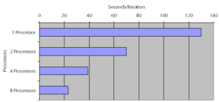

You will experience significant drops in run time with Cube Cluster. For example:
Image 1 – Example of Highway Assignment speed test

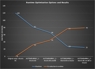

Image 2 – Example of reduction in runtime for a matrix program looping across several operations

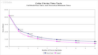

Image 3 – Runtime tests with Cube Cluster

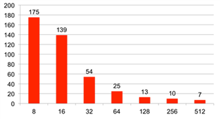

Image 4 – Runtime in hours by number of cores for the Nashville case study (test in Cube Cloud)
