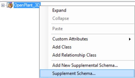

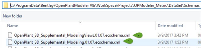

- In Class Editor, Open OpenPlant_3D.01.07.ecschema.
- Supplement it with below schema’s.

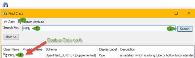

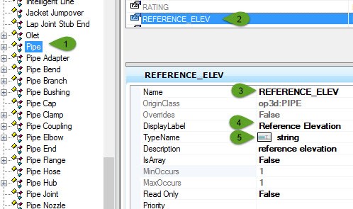

- Navigate to PIPE class. See below image to search PIPE class.

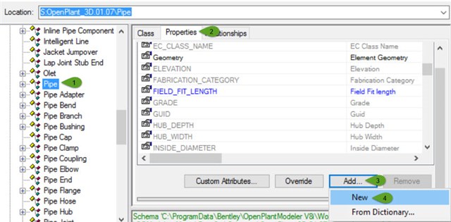

- Go to Properties Tab.
- Create a new property say REFERENCE_ELEV. To add a new property, user can either copy-paste existing property or can create using New button.

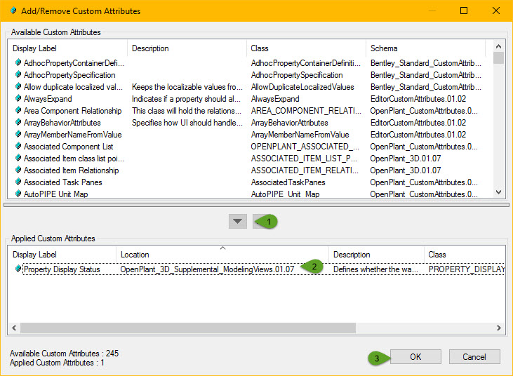

- Add Custom attribute Property_Display Status. Enable fields as Editable. See image below.

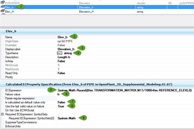

- Create Property, say Elev_H for showing the elevation difference with respective Tiers defined by users.

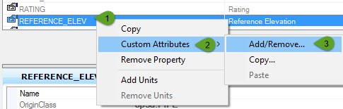

- Assign Custom attribute, CalculatedEcPropertySpecification, using Add/Remove button.
- Define expression, enter other fields as mentioned in images below to get the round value for string type property.
System.Math.Round((this.REFERENCE_ELEV-this.TRANSFORMATION_MATRIX.M11/1000),0)
- Add custom attribute
- Similar add a new property Elev_h and repeat steps 9-10 shown above.
System.Math.Round((this.TRANSFORMATION_MATRIX.M11/1000-this.REFERENCE_ELEV),0)

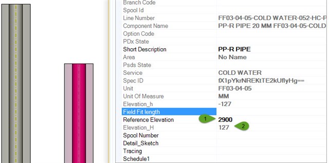

- Launch OpenPlant Modeler. Select a model containing Pipes with various elevations.
- Select Pipe and enter the REFERENCE_ELEV value. Enter it for each pipe.
- Using EC Annotation, display the desired length for each pipe. See wiki article under See also section for reference.
