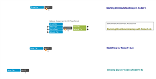

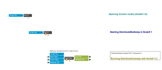

Steps 1 initiates the Cluster executable. Steps 2 initiates the DISTRIBUTEMULTISTEP command for the Peak Period highway assignment. Step 3  invokes IDP for the same period highway. Step 4 ends the DISTRIBUTEINTRASTEP for the current period assignment and initiates the MDP for the off-peak period assignment. Step 5 invokes IDP for off-peak. Step 6 ends the DISTRIBUTEMULTISTEP for the second period assignment. Finally, step 7 ends the Cluster executable.
The major Voyager scripts are indicated as follow:
*"C:\Program Files (x86)\Citilabs\CubeVoyager\Cluster.EXE" TEST 1-6 Start Exit
DistributeMULTISTEP ProcessID='TEST', ProcessNum=1
RUN PGM=HIGHWAY MSG='Highway Assignment for Peak Period'
   DistributeIntraStep ProcessId='TEST', ProcessList=2-3
ENDRUN
EndDistributeMULTISTEP
DistributeMULTISTEP ProcessID='TEST', ProcessNum=4
RUN PGM=HIGHWAY MSG='Highway Assignment for Off-Peak Period'
   DistributeIntraStep ProcessId='TEST', ProcessList=5-6
ENDRUN
Wait4Files Files=TEST1.script.end, TEST4.script.end, CheckReturnCode=T
*"C:\Program Files (x86)\Citilabs\CubeVoyager\Cluster.EXE" TEST 1-6 Close Exit
