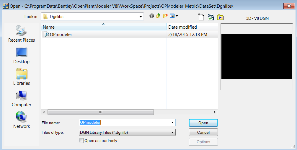

- Go to File from Main Menu option and open DGN library files (dgnlib). See image below :

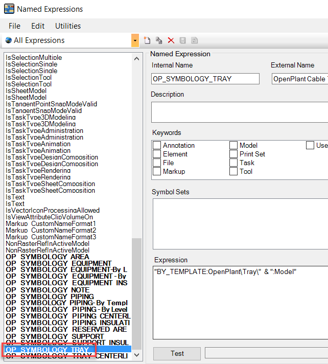

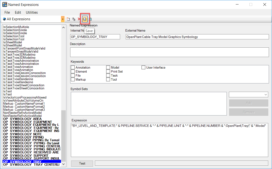

- Under Utility Menu, Select Named expression and click on OP_SYMBOLOGY_TRAY. See image below for reference.

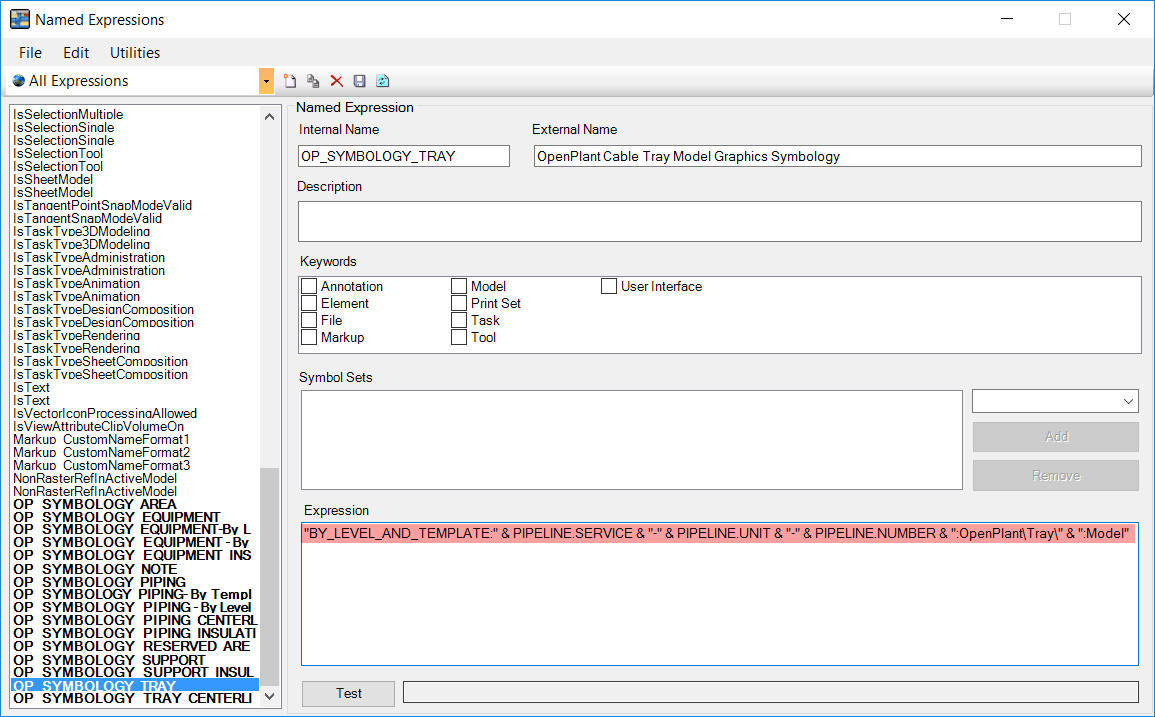

- Below are the Symbology pasted to copy from here and to get it pasted to the respective Expression of OP_SYMBOLOGY_TRAY:
"BY_LEVEL_AND_TEMPLATE:" & PIPELINE.SERVICE & "-" & PIPELINE.UNIT & "-" & PIPELINE.NUMBER & ":OpenPlant\Tray\" & ":Model"

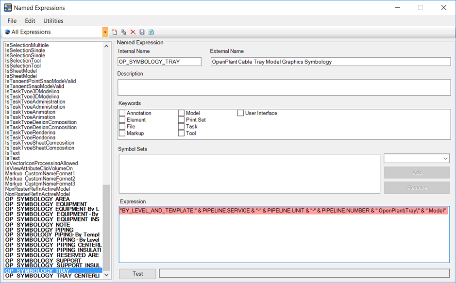

See the image below for reference
NOTE- You can change the sequence of unit, service and number not use all three as per requirement

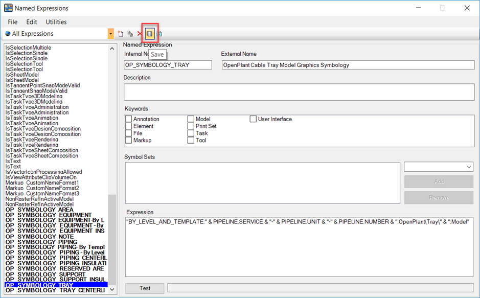

- Save the Expression which turns blue. Save option will get enabled once you modify the Expressions: See below for reference.

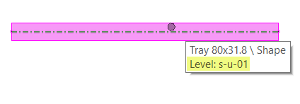

- Launch OpenPlant Modeler and Verify results. See images below:
Pipeline Level as 'TRAYLINE.SERVICE-TRAYLINE.UNIT-TRAYLINE.NUMER
