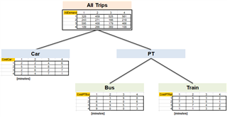

The structure of the mode choice in this example is shown below:
In this example:
In this model the process begins in the PT nest, and then we move up the hierarchy.

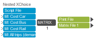

The example has four zones, and the inputs are the cost matrices and total demand matrix ("all trips") to be split.
The cost matrices are shown in the image below:
In this example, we used the two scale parameters below:

XCHOICE,
;     List choices
  ALTERNATIVES = car bus rail,
;     Input demand
  DEMANDMW = 1,
;     Input costs
  COSTSMW = 4, 5, 6,
;     Output calculated demand
  ODEMANDMW = 14, 15, 16,
;    Model Structure
;      Top level nest model specification
  SPLIT = TOTAL lambda car pt,
;     Forecast composite cost top level
  SPLITCOMP = 19,
;      PT nest model specification
  SPLIT = PT mu bus rail,
;     Output calculated composite cost PT nest
  SPLITCOMP = 20,
;    Working matrices
  STARTMW =70
