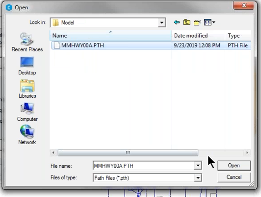

 Open from the tutorial model download (A very simple 25-zone Model created for this demonstration) the Macro2Meso(.cat) Catalog File

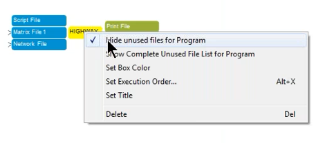

If we select the Hide unused files for Program the Path File should continue to be visible.

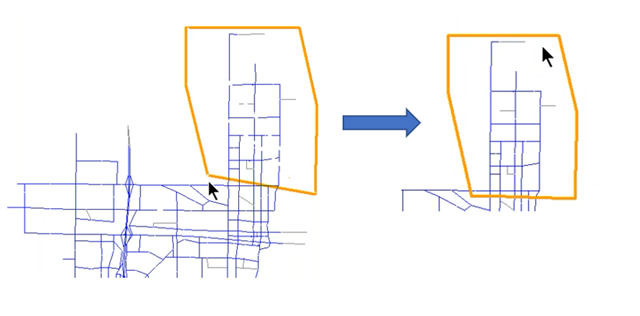

2.    Sub-Area Extraction
If your Polygon needs to be edited, click on Restore this will allow you to drag around the points to its new location.
Once you have the polygon ready
A ‘Sub-Area Extraction Node Renumbering’ window will pop-up. (You can keep the default numbers for the ‘Renumber Option’ or change them).

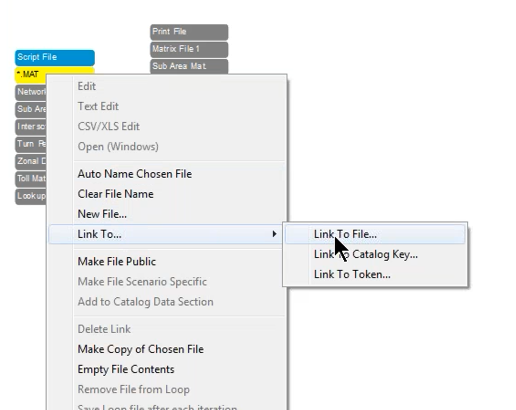

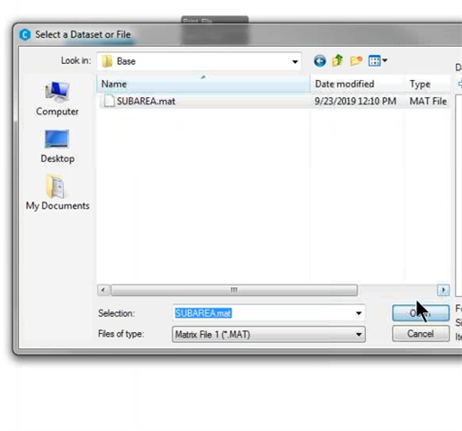

You will need a corresponding matrix to be the input of the sub-area. To do this:

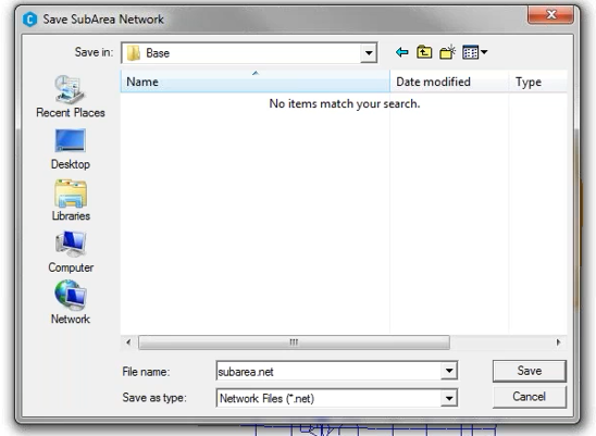

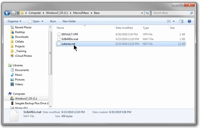

If we look in our ‘Base’ folder we will now find a network (.net) and a matrix (.mat) for our sub-area.
If we open the Network file we can see what our sub-area looks like. You can play around with the Post Node tools to change the display of the sub-area (e.g. Show number of zones)

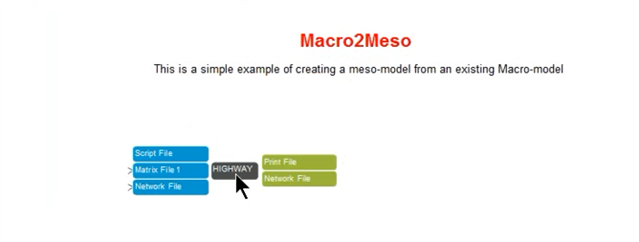

3.    Create a CUBE Avenue Model
Once the Module is launched, we need to select the inputs and create 2 output files.

A good practice is to always create a Print File too, therefore repeat the same procedure for the (*.PRN) file as well
After ‘Hiding Unused Files’ the model will look like this:

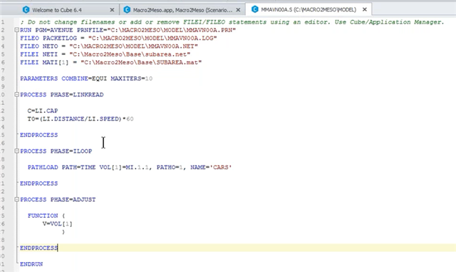

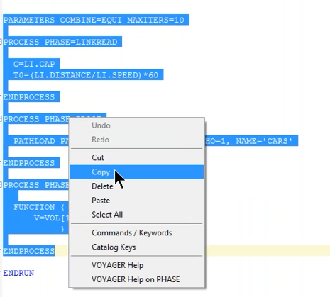

To create the Mesoscopic Model:

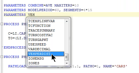

We will then have to do a few changes to the new script:
Parameters:
TIP: CTRL+ALT+SPACE to auto-create keyboard

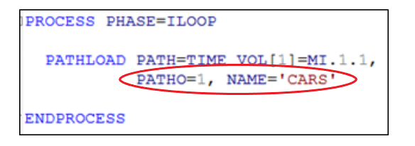

LINKREAD phase will remain the same.
ILOOP Phase:

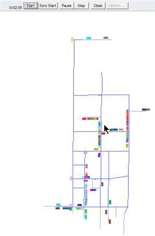

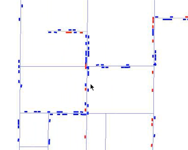

Avenue allows us to perform an animation:
The animation will allow you to understand how congestion happens according to the different time segments.
If you need to make changes:

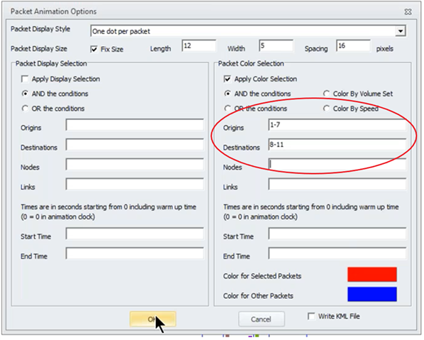

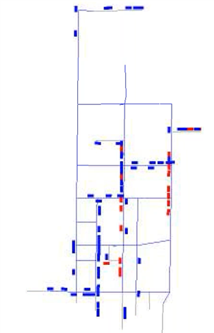

If for example you only want to see the packets leaving from Origin 1-7 and Destinations 8-11 you can make those changes in the ‘Packet Animation Options’ window.
In this case red packets are originated from zone 1-7 and are going to 8-11.
You can also increase the speed to better visualize and understand bottlenecks in the corridor.
