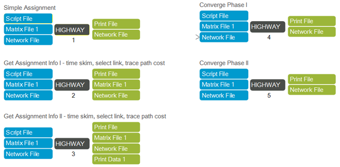

1. HIGHWAY 1:
Gives you one simple example of assignment. Please run it and check its PRN file. You can also open the output network (loadedNet1.net). You will find new attributes added to this network (V_1, TIME_1, etc). If you are not sure about what they are, then please consult the Cube Help.
2. HIGHWAY 2:
This program shows how to use PATHTRACE, SELECTLINK, and TRACE. PATHTRACE gives you the skim matrix in TIME (one can change it to Distance or LW attributes). SELECTLINK will gives you the volumes using LINK=101-102. One can verify it in the output network. TRACE gives you the detailed path information and you can find it in run PRN file:

Some users may not need combined skim matrices and/or need detailed information of the path. One can use COMBINE=F under MATO to get the statistics only at the last iteration and use PRINT and LIST with TRACE to print out path information into an external file. They are shown in this program. Just check the output skim matrix and the path file gives the link by link information.

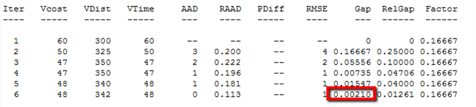

Some users will think by the settings, the run will either terminated at Iteration 50 or when the gap is 0.001. Now run the program, and check the run PRN file. From there, we can find the process terminated at iteration 6, with gap value = 0.00210
How does that happen?
The reason is that there are a set of stopping criteria used by Cube and each of them has a default value.See below:
PAR: LAMBDA=0 GAP=0.005 AAD=0.5 RAAD=0.005 PDIFF=1 RMSE=0.1 PDIFFVALUE=0
PAR: RELATIVEGAP=0
By setting GAP=0.001 one just change the default value for GAP. But the program will check all above criteria and terminate the process if any of them met. In our case is ADD!
5. HIGHWAY 5:
In this program, we will add a CONVERGE Phase to fully control the convergence checking process of the assignment.
