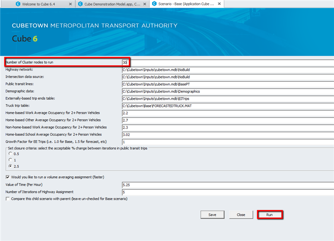

Step 4: Update Cluster keys
Update any keys related to Cluster settings. Most models will have an input key which will allow the user to set the total number to processing cores, to be used for a run. Update this key value to match with the process list identified in Step 2. If the maximum number in the process list is 30, set the scenario key value to 30.
Step 5: Start model run
Start model run from the scenario manager on the main computer.
e.g.
