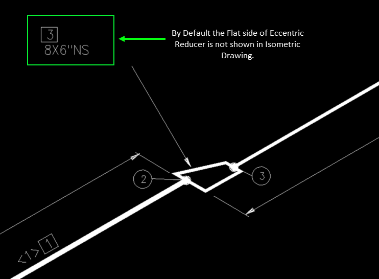

By default the Flat Side of Reducer is not shown in the Isometric Drawing. User need to make certain changes in the Project Administrator to achieve that.

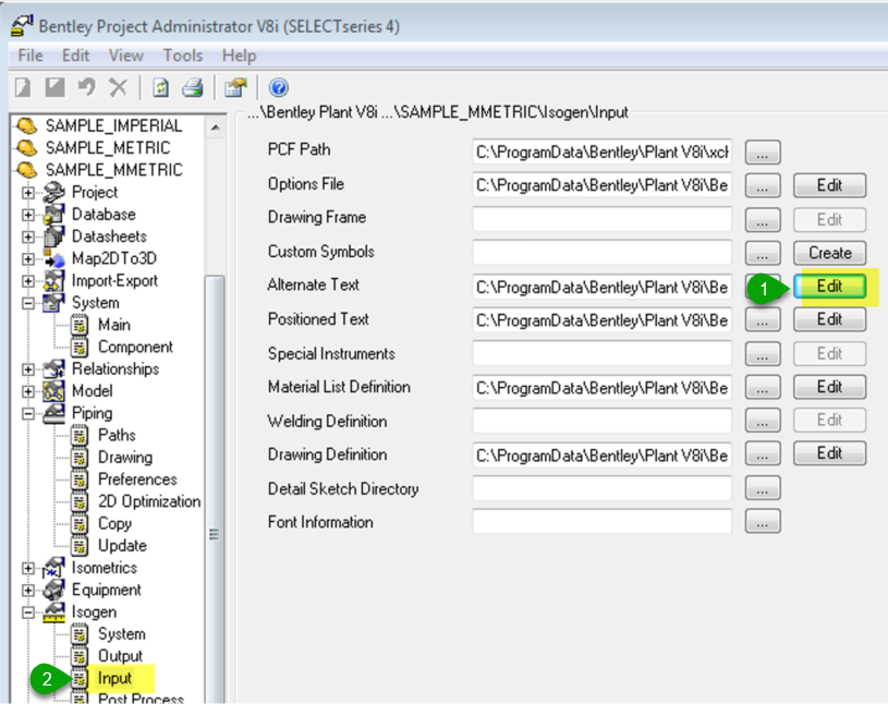

1. Open Project Administrator.
2. In Project Administrator edit the Alternate Text as per below mentioned screenshot.

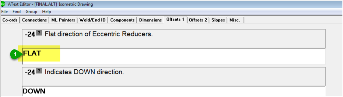

3. In the Alternate Text Editor open the Offset 1 tab as mentioned in the below screenshot.
4. In the offset 1 tab the annotation can be changed to Flat as mentioned in the below screenshot.

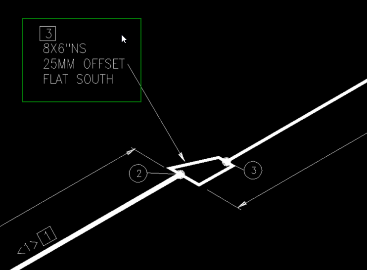

5. Save the changes made and generate the Isometric to check/confirm the results.
