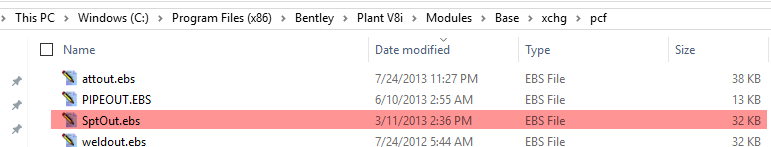

To increase the Support Tag Field character length as per the user requirement.
By default the Support Tag length character are 32, The user should be able to modify the required length for support Tag as required.
Steps to Resolve
  1. Close all AutoPLANT applications.

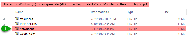

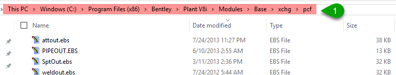

  2. Go to following location C:\Program Files (x86)\Bentley\Plant V8i\Modules\Base\xchg\pcf.

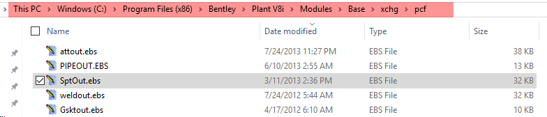

  3. Open sptout.ebs file.

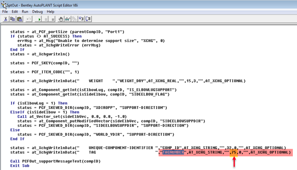

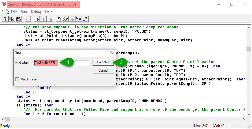

  4. Search for "TAGNUMBER" as mentioned below.
  5. Change value 32 to the required value (here tag value of 75 is taken)

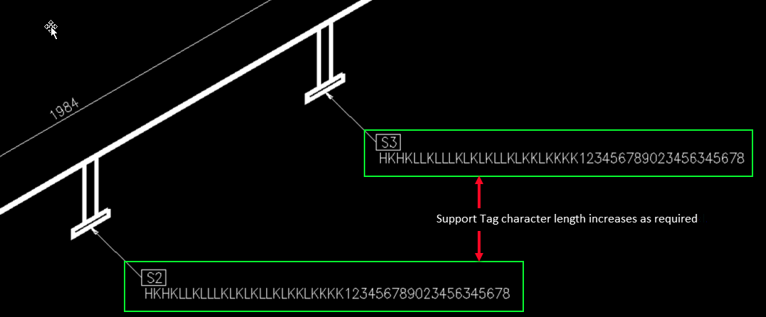

  6. Save the file and generate Isometric to review the result.
