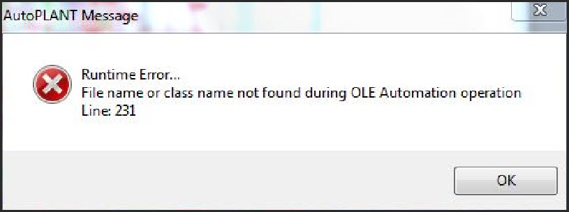

While trying to build an annotation string, the following series of errors occur
AutoPLANT Message
Runtime Error… File name or class name not found during OLE Automation operation Line: 231

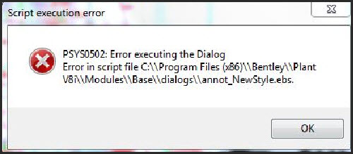

Script execution error:
X PSYS0502: Error executing the Dialog
Error in script file C:\\Program Files (x86)\\Bentley\\Plant V8i\\Modules\\Base\\dialogs\\annot_NewStyle.ebs

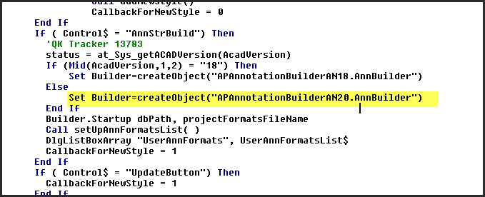

Below are the illustrative steps to resolve this issue.
Steps to Resolve
  1. Close all AutoPLANT applications
  2. In Windows explorer, open the following file in Script Editor.
    C:\Program Files (x86)\Bentley\Plant V8i\Modules\Base\dialogs\annot_NewStyle.ebs
  3. Go to line number 231 and notice the following line:
    Set Builder=createObject("APAnnotationBuilderXM18.AnnBuilder")
  4. Above variable should point to APAnnotationBuilderAN20 depending on the user`s AutoCAD version. As an example, change the line as follows,
    Set Builder=createObject "APAnnotationBuilderAN20.AnnBuilder")
    Refer following screen shot:
  5. Save the file and restart AutoPLANT
