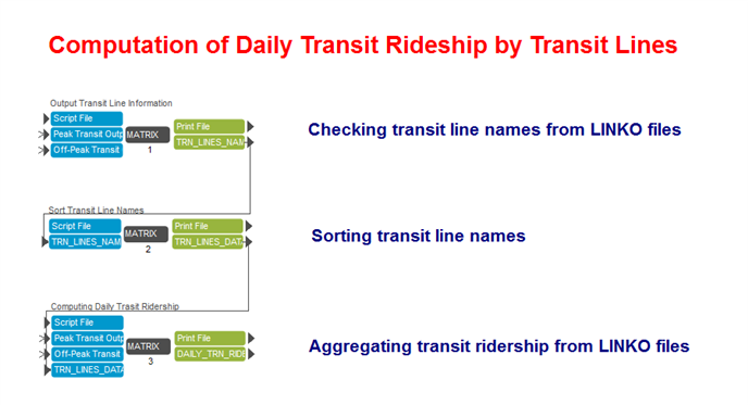

How to aggregate transit ridership per each transit line using LINKO files in PT?
Product(s):Cube
Version(s):6.1 to 6.5
Area:Public Transport
The attached zip file includes the below Cube catalog example to show how to aggregate the transit ridership per each transit line using the ‘ONA’ field (boarding) in the ‘LINKO’ output file that is generated as one of output files in transit assignment. The ‘ONOFFS’ sub-keyword along with ‘LINKO’ should be set as ‘Y’ (true) to include boardings and alightings at each stop in output file of PT.
The above Cubetown example computes the daily transit ridership using only two ‘LINKO’ files as peak and off-peak periods, but one can add more ‘LINKO’ files with updating the existing scripts in Steps #1 & #3. Note that only ‘LINKO’ files are required to be processed.
