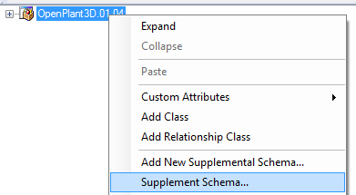

  2. Load the primary schema OpenPlant_3D.01.04.ecschema.xml, if the intent is to make changes to the actual primary and supplemental schemas to check-in the changes into CVS. For customizing the merge schema, simply load the merge schema from the AutoPLANT project location, and move on the step 5.
  3. Once the primary schema has loaded, right click the schema name in the Class Editor browser and select Supplement Schema. Browse to the OpenPLANT_3D_Supplemental_Mapping_AutoPLANT.01.04.ecschema.xml and supplement it

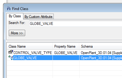

  5. If the OP class name to which the AP class is to be mapped is known, then simply press Ctrl + F and enter the OP class name in capital letters. Class Editor will then provide the class in the listbox in the dialog which can then be double clicked to go to the respective OP class in the hierarchy.

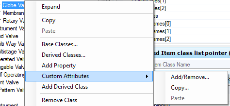

  6. Selecting the OP class in the class browser would show its ‘custom attributes’ in the right pane, one of which should be ‘AutoPLANT_PDW_Class_Map’.
  7. If there is no custom attribute with the name AP_3D_ClassProperties, then select the OP class, right click, and select Custom Attributes > Add/Remove.

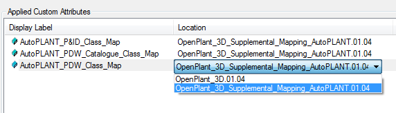

  8. In the dialog that opens up, select the ‘AutoPLANT_PDW_Class_Map’ to add it to the ‘Applied Custom Attributes’ list.
  9. Select OpenPLANT_3D_Supplemental_Mapping_AutoPLANT.01.04 in the ‘Location’ field. This is only required if the supplemental schema has been mapped onto the OP 3D primary schema.
  10. Press OK. The custom attribute should now appear in the right pane if it was not already there.

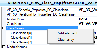

  11. Right click on ‘ClassNames’ and ‘ModuleNames’ to add elements in each and then write down the AP class name and the class’ module in the two new elements.

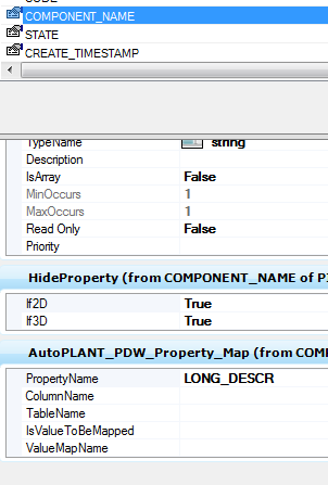

In order to export necessary information to write to the ECXML for consumption by OPIM, several AP class properties need to be mapped to existing properties in the OpenPLANT schema. For example, the COMP_LEN property in AutoPLANT, which defines the total length of the several components from one end to the other, has been property mapped to END_TO_END_LENGTH for every applicable class. Thus, the value stored in the COMP_LEN field in AutoPLANT component would then be recognized by the conversion process as END_TO_END_LENGTH, and would be consumed by OPIM accordingly.
Several property maps have already been defined in the classes higher up in the hierarchy, from which the classes at the bottom of the hierarchy derive their properties, with some specialized addition properties of their own. The PIPING_COMPONENT class in the OpenPLANT schema houses several properties used by the piping components under it, however there are several properties that are only to be added for special components, and should not affect other classes in the PIPING_COMPONENT hierarchy. The class hierarchy in the OP schema helps in organizing the classes under appropriate generic parent classes.
As before, the procedure to define a property map involves adding the ‘AutoPLANT_PDW_Property_Map’ from the custom attributes addition dialog. Once that is done, an empty section for the AutoPLANT_PDW_Property_Map should appear. Write down the AP property in the PropertyName section for the new custom attribute, as shown in the image on the right.

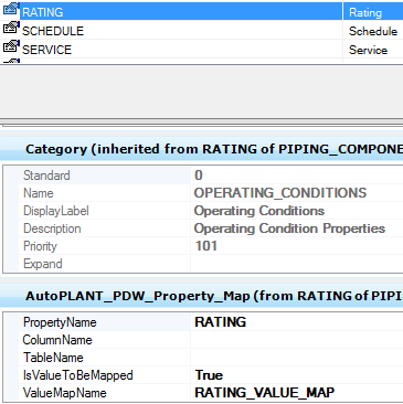

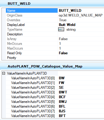

Value maps are required to map values like component end conditions in AP to the ones defined in the OP schema. For example, the end Threaded Female end condition defined in AP is SCF, whereas the Threaded Female end condition defined in the OP schema is FT. Even though you may property map the END_COND_1 to END_PREPARATION in OP, the value map would still have to be defined because both have a different way of representing something which basically means the same. Unlike numerical values like those in the COMP_LEN field or the PIPE_OD_M field, the end conditions contain strings which are different for both the AP and the OP system. Similarly, the RATING field in the AP system would have a different way of representing valve/flange ratings, whereas the OP schema would have a different rating value representation.
The procedure for defining the value map starts by first defining the correct property map, as has been detailed in the Property Mapping section above. The additional work required for defining a value map is to set IsValueToBeMapped to True, and to specify the ValueMapName which points to a sub-class under the VALUE_MAP class in the schema.

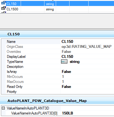

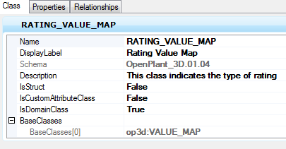

Consider the rating value map, for example. The image below shows how the IsValueToBeMapped and ValueMapName have been defined in the AutoPLANT_PDW_Property_Map custom attribute for the PIPING_COMPONENT class.
Notice that IsValueToBeMapped has been set to True, and the relevant VALUE_MAP sub-class has been specified for ValueMapName. Now, using Ctrl + F, search for the already defined RATING_VALUE_MAP to see what it looks like, and it leads us to the class shown in the image below:
It is important that the ValueMapName should match this new class defined under the parent VALUE_MAP class.  Clicking on the Properties tab for the RATING_VALUE_MAP shows us all the value maps pertaining to this class. Clicking on CL150, for example, would show that it has been mapped to 150LB using the ‘AutoPLANT_PDW_Catalog_Value_Map’ custom attribute.
So, when an export is done using these value maps, the RATING or CONTACT_RATING property in the ECXML generated would have the corresponding values defined in the OP schema. For example, if the user runs the AP2EC conversion process on a flange with a 150LB rating defined in AP, the ECXML would have RATING specified as CL150, in the following XML format:
<RATING>CL150</RATING>
There can always be multiple values coming from AP that can be value mapped to a particular OP value. For example, multiple types of butt-welds coming from AP have been mapped to the BUTT_WELD class in the OP schema, as shown in the image below.

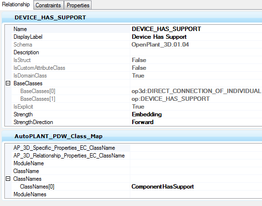

Relationships between various entities in the ECXML’s have to be defined in order to ‘connect’ the entire assembly of entities/components together. A relationship can be something like Joint has Port, or Valve has Valve Operating Device, or Device has a Support. The relationship connects to OP class entities together in its definition in the schema, and is eventually printed in the ECXML’s for consumption by OPIM.

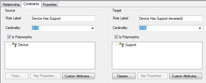

Let us take the Device_Has_Support relationship as an example. This relationship has been defined to define a connection between an entity under the DEVICE class, and an entity under the SUPPORT class in the OP schema.
The Device_Has_Support class residing under Relationship Classes has a AutoPLANT_PDW_Class_Map custom attribute defined. The class defined here is used internally by the AP2EC conversion process to map to the proper relationship, so obviously it is not to be tampered with for pre-defined relationships.
The constraints tab specifies the Cardinality. A pipe can have multiple supports, so the cardinality would be (0, 1) to (0, N).
Notice how the Source section has Device class defined in the box, whereas the Target class section has the Support class defined. The statement ‘pipe has a support’ is logical, rather than saying that ‘support has a pipe’, since a pipe can have multiple supports on it.

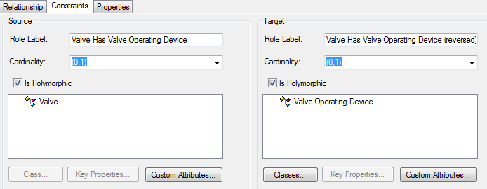

If we look at the Constraints for the Valve_Has_Valve_Operating_Device relationship, it would be observed that the Cardinality is (0,1) to (0,1), since one valve will always have just one topwork/regulator on it.

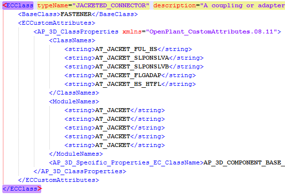

If the Class Editor software is not available to modify your merge schema, you can always use any popular text editor software like Notepad++ to manually make amends/additions to your ecxml.xml file residing in the Config > OpenPLANT > Schemas folder location of your project root. For example, adding a new AP class mapping to an existing OP class would simply require the addition of the following lines under the AutoPLANT_PDW_Class_Map custom attribute:
<ClassNames>
              <string>YOUR_AP_CLASS</string>
</ClassNames>
<ModuleNames>
             <string>YOUR_AP_CLASS_MODULE</string>
</ModuleNames>
Below is a snapshot of the AP class mappings of the JACKETED_CONNECTOR class. Notice that multiple classes have been mapped to this EC class.

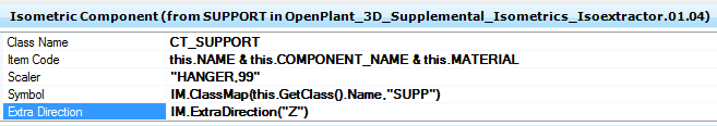

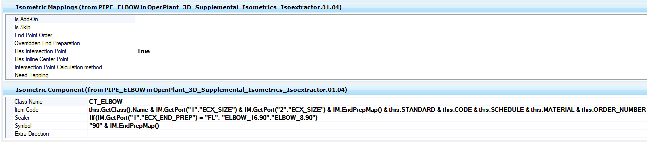

Here’s a snapshot of the Isometric Component custom attribute of the PIPE_ELBOW class. All isometric component custom attributes can be seen alongside the AP custom attributes once the isometric schema is supplemented.
The Item Code concatenates several properties together and stores that in the isometric component as IE_CODE. The isometric generation process would throw an error if any of these properties is not mapped correctly. The Class Name is also stored in the isometric component as IE_TYPE.
The Scaler and the Symbol are instrumental in defining the structure of the isometric component’s symbol and the graphics of the symbol itself, respectively. However, other changes/additions need to be made if an entirely new symbol is to be defined.

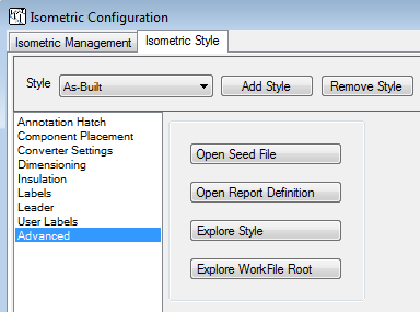

  1. Launch OPIM in the desired project.
  2. Go to Tools > Configuration.
  3. Click on the Isometric Styles tab, and select Advanced in the panel on the left.
  4. Click on Open Seed File to launch OPIM.

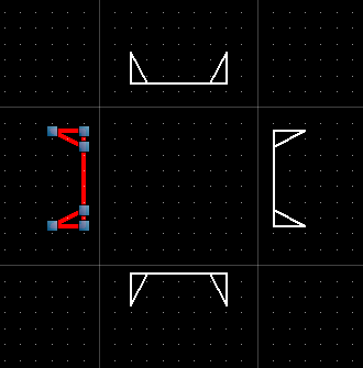

  8. Now drag a window around one of the existing symbols that looks that most like your desired symbol, depress the right click button and select Copy. You may want to draw your own symbol, for which you can use standard Microstation drawing tools available on the left.
  9. Click on any empty space to paste the block.

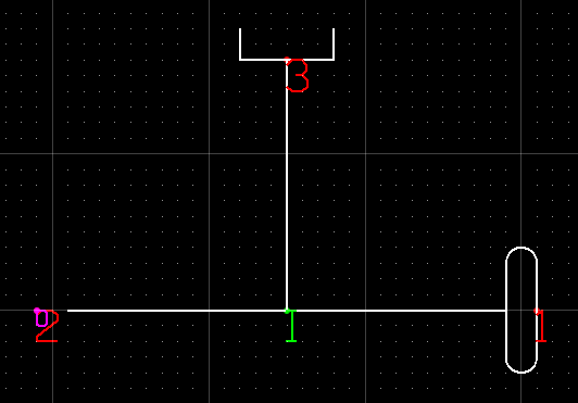

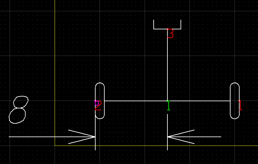

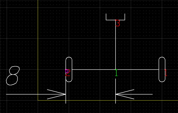

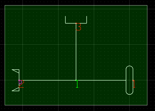

  10. Click on the Linear Dimension tool on the left of the Microstation window.
  11. Click on the far end of one end and then at the center of the tee symbol. Place the dimension by right clicking in the draw area.
  12. This dimension is the entire segment length of the symbol defined in the symbolsizes.def file. Note how the end condition takes up a small portion of this length, and does not extend beyond the segment length. However, the female end at the branch needs to have its port at the termination point of the line so that the connecting isometric component starts from that point.

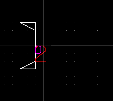

  13. For this example, the port 2 end condition needs to be replaced by a female threaded end condition. So the first step would be to delete the end condition graphics at port 2. It results in the following:
  14. Now pan the drawing to the Endprep Templates drawn above, right click the end condition pointing towards the left and copy it.
  15. Pick symbol from one of the end points in its geometry, and align it with your copied symbol in such a way that the end prep’s vertical line coincides with the port 2 point on your copied symbol.
  16. Notice the gap between the line and the end condition. Drag one end of the line towards point 2 to complete the symbol graphics.
  17. Now select all the connection and intersection points and delete them.
  18. Click on Place Connect Point in the IsoExtractor Cell Creation toolbar.
  19. Start clicking on the locations where the points once were. It is important here to note that the order in which the points are clicked on the geometry specifies the port ordering. So, the first point click would be on the right of this example, the second on the left where you placed your new end condition, and the final click would be at the end of the branch port.
  20. Then click on the Place Intersection Point button in the IsoExtractor Cell Creation toolbar and click on the intersection point of the geometry’s segments.

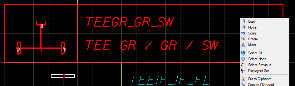

  21. When all points have been defined, select the Place Fence tool on the left side of the Microstation window and create a fence around the entire geometry.
  22. Once the fence has been created, click on the Create Cell button in the Cell Creation Tool toolbar.
  23. In the dialog, select custom.cel to store this “cell” (or “block”, for those familiar with AutoCAD terminology).
  24. Enter TEEGR_FT_SW in the cell name section, and the description in the Description section. The end conditions specified in the name should be in the order of the points placed on the symbol. So, in this case port 1 is GR, port 2 is FT, and port 3 the branch is SW.
  25. Your symbol has now been saved.

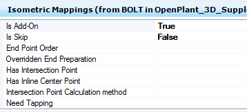

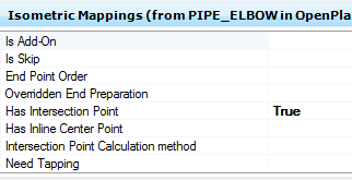

Isometric Mappings custom attribute
Another important isometric supplemental schema custom attribute is Isometric Mappings. It provides various control options to specify the structure of the isometric component, whether it is an add-on type of component, whether it needs to be displayed or not, etc. Consider the Isometric Mappings custom attribute for the BOLT class as an example, shown in the image below.
It tells the isometric generation process that this particular component is an add-on component, and that it should not be skipped. There are some cases where particular AutoPLANT entities/components have to be skipped, i.e., they are not represented anywhere in the isometric. For example, the AT_GLAND class in the Ductile module. It is part of a complicated mechanical joint assembly which has several fasteners, and most of them have been incorporated in isometric component definitions in IsoExtractor. So, since mapping could not be ignored because that would give missing mapping errors, this component was mapped to the GLAND class which has Is Skip set as True in its Isometrics Mappings custom attribute. This would allow the AP2EC ECXML generation process to push this component through, but the isometric supplemental schema would disallow this component to be displayed on the final isometric.
Also notice how the Has Intersection Point in the Isometric Mappings custom attribute for the PIPE_ELBOW class has been set to True, since this two port component has an intersection which connects to the two ports with two segments.
