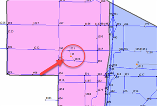

2. Here, we have a network of Cubetown, the associated TAZ file, coloration for nodes, links, and TAZs. The labels displayed are for the zones. You will notice that there are 25 zones but one is missing. We will create a new centroid and centroid connectors for this zone.
4. In this example, we have a zone with missing centroid and connectors (above image). Click on an existing centroid and copy its attributes (CTRL+C).
5. Pressing CTRL+V will close the existing centroid's attribute window and display a black cross-hair icon. This will allow you to create the new centroid node. Click in the middle of nodes 1221 and 1220.

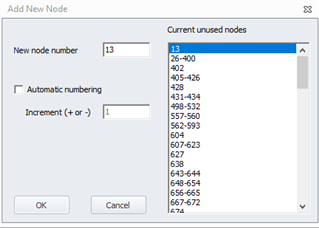

6. Zone 13 is missing. So type in "13" or double-click it from the Current unused nodes box. Click OK to create the centroid.

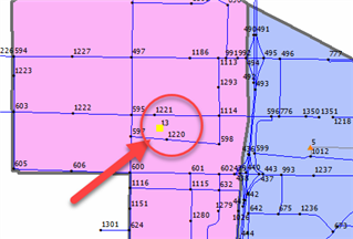

7. Next, use the pointer tool and select an existing centroid connector and copy its attributes (CTRL+C).
8. Click on the Add Two-Way tool > draw connectors for links 1221-13 / 13-1221 and 1220-13 / 13-1220. After each connector is drawn, you need to click anywhere outside the new links to confirm the sketch. Click Save in the upper-left part of the CUBE screen to save the new changes.

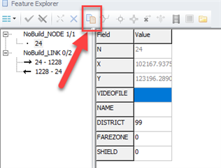

13. The Edit Feature tool should have been auto-selected. Next, we will repeat the exercise with zone 13. Click on any existing centroid > its attributes should show up in the Feature Explorer.
14. Click on the Set Current Feature Attributes as Template icon.
15. Click Create Feature Tool > draw in the new centroid similar to step #8.

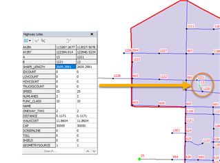

16. From the Layer Controls drop-down arrow > select NoBuild_Link. We will now draw in the new centroid connectors. Save the edits when prompt. Confirm the Edit Feature and Two-Way Editing tools are active.
17. Select an existing centroid connector and repeat step #14 to copy its attributes.

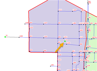

18. Repeat step #15 to draw in the new connectors. Single-click to create the initial node connection. Double-click at the opposite end to create the two-way connector.
19. From the Editor > Save Edits > Stop Editing.
