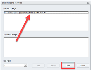

2. Click on the Analysis tab > Link a Matrix
3. Load your matrix if you have one in this window and click Close.
