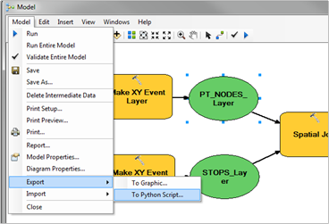

With Model Builder in ArcGIS we can build the model very easily, as shown in the example below.
The model script can be quickly exported to Python script as shown below (Model > Export > To Python Script…).

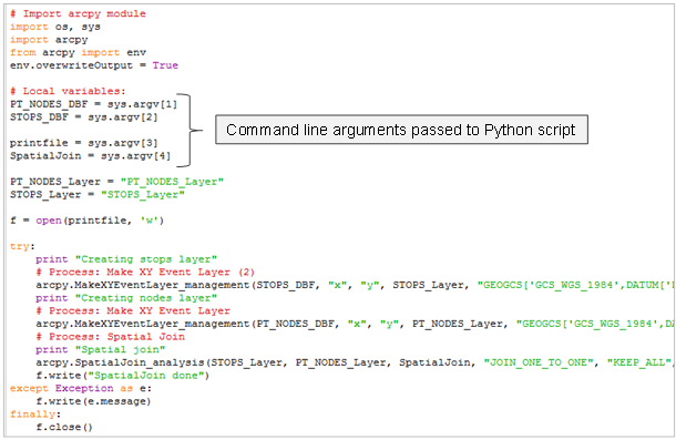

A Python .PY file is then created, containing the script as it is executed through Model Builder.
The script can be refined if needed, but the only necessary edits are the two steps below:
Some further edits have been made in this example:

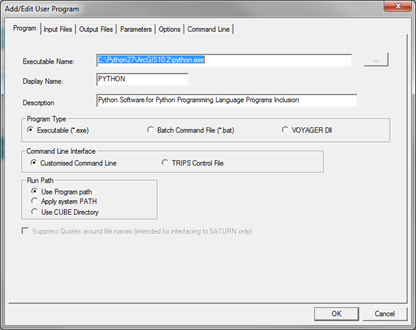

Click on “User Programs > User Programs Settings…” to edit existing programs or add a new program.
The User Program Settings window contains the full list of your User Programs, Click “Add…” to add the new User Program.
The Python.exe program can be included in Cube directly as an executable (Pythonw.exe if we do not want to pop-up the command prompt when Python is executing). Specify the Program as below, browsing to the Python.exe file location, depending on your installation.
As you can observe in the picture, we are going to pass the information needed to Python on the Command Line.

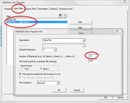

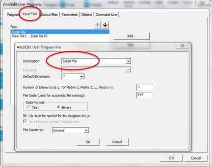

Then we need to proceed in defining the remaining components of the Program Interface. We define Input and Output Files as below (with the Script File and allowing 10 inputs and 10 outputs data file, as an example).
Note that Input files defined as text (rather than binary) can indicate whether they may contain catalog keys.
Define the Command Line Arguments (sys.argv[#] in the Python script), considering the inputs and outputs, as below

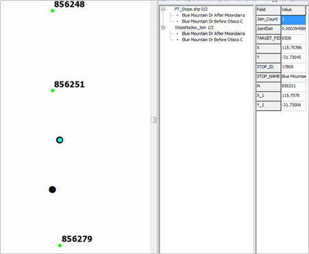

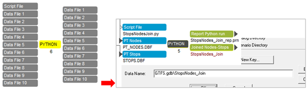

When clicking “OK” and going back to the Application Manager, we can now include Python by selecting “User Programs > PYTHON”, and this will be an empty box, ready for us to fill in with the necessary script file, inputs and outputs. In our example the inputs are the PT nodes and PT stops DBF file (dynamically linked from the outputs from other conversion steps). The outputs are the prn file containing the run report and the stop nodes feature class contained in the GTFS.gdb, with the result of the spatial join.
The input Script File can be now edited directly within the Cube Text Editor, by double clicking on it within the Application Manager. In our example, the stop nodes are joined to the closest PT node, as it can be observed in the picture below.
