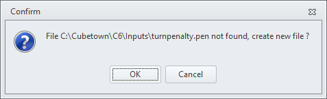

Click on Turn Penalty File and upload the existing turn penalty file or type in the name of a turn penalty file if no file exists. The following prompt will come if a new file name is given. Click OK.

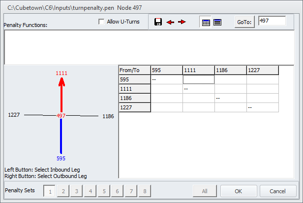

When the file is loaded or created, the Turn Penalties option will be active under Intersections tab. Next, click on any node in the network where you wish to create a turn penalty or update any existing penalty. Then, click on Turn Penalties as below.

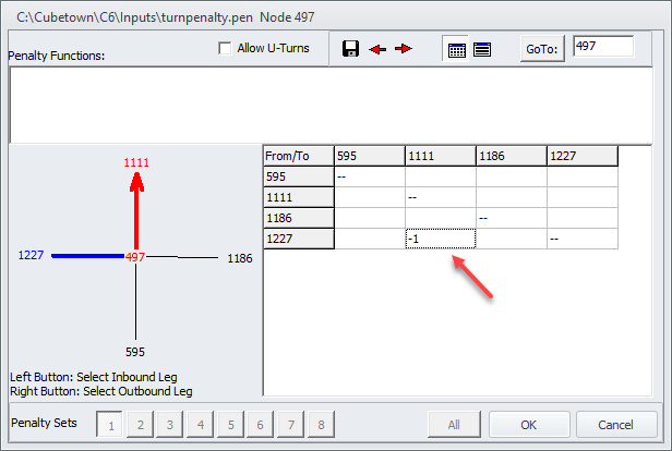

A dialog box for that node/intersection will pop-up. To enter new penalties, click on the respective cell in the middle and enter the value. When an individual cell is clicked, the turn movement on the left-side will dynamically change for your reference on which turn that cell belongs to.
E.g., If you click on 1227/1111 cell and enter -1, the turn movement will change as well. See below.
 You can click on 'set' to set turn peanlty values for different sets. Click OK when done.
