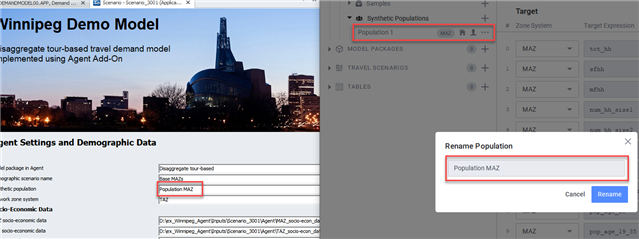

When you open Agent through CUBE, you will see a window like the one below opening up, showing you the arguments that you passed to the Python script that are initializing your Agent model. The Agent window will be opened behind that window. Do not close the Python window when working in the Agent window.
Once the Agent GUI opens up, with your network and demographic scenarios already populated through the previous steps from your set of inputs coming from CUBE, then you can proceed with building your Agent model through the interface.
To make things quicker for the purpose of the demo, we have prepared some specification files to be used directly, avoiding having you to re-build the entire model:
Note: the name of this Travel Scenario is specified in the specification file created within CUBE. If a different name is to be used, this needs to be updated in CUBE under the catalog key (scenario specific): {model_package}
Once the Population Synthesis and the Model Package have been created, close the Agent GUI (click "Confirm" when asked to close the GUI).
From this point on, the Travel Scenarios will be created for any new scenario directly through CUBE, without the need to open Agent again.
If double-clicking again the same Pilot step mentioned above to open Agent, this will just open the Agent GUI again but with the existing specifications with the most updated data from CUBE, it will not re-create the project.
Once the above steps are undertaken and the Agent window has been closed, it is possible to run the entire Scenario_3001 by double clicking on it within CUBE Scenario Manager and click “run”, making sure to uncheck the box selecting the "set-up mode"
