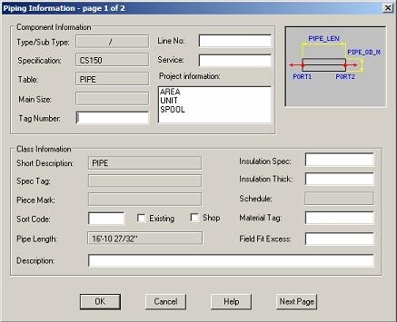

- Now, when I use the command Edit Component, I see a screen similar to this.
Empty Edit Component Dialog
As you see, there is no component data. This can cause many issues going forward.

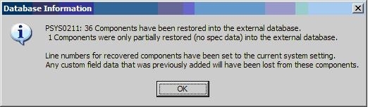

The first thing to do is recreate the components in the project database, to take all the components from the file and create then in the Piping table.
- To do this, use the command:
AT_DBPIPE_RECOVERDATA
- When the Piping table has been populated, a dialog like the following one appears
Database Information

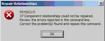

- Specifically, since AutoPLANT cannot determine the correct project objects to use for the components in this example, it will use the defaults. For example, since we removed all relationships and components, there is no way for AutoPLANT to have the correct project objects. As a result, it will inform you that there is no Service called S100 (the default).This is the error message displayed:
Repair Relationship Error
- This is text from the command line:
Processing component: AT_F5WHI1AU_10
Error: ATDB0719: Relationship Manager error code reported -213131
modPreference.GetPrefernceValue : Service instance doesn't exist.S100
- You will have to create a service called S100 and then run the command again. The next time you run it, you will see:

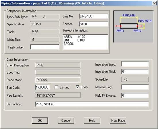

- So now if you run an Edit Component command, you get:
Edit Component w/ data
- You can now see the component data from the recreated components. Many times this step will get you back up and running. However, you may see issues with components not being associated with a valid spec record. In this case, the next step is to run the following command:

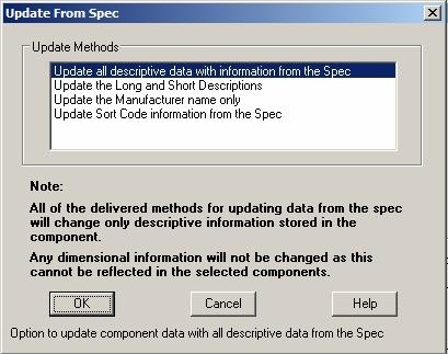

Piping --> Database Tools --> Update From Spec
- Choose All from the component selection dialog and the system displays this dialog:
Spec Update Dialog
- In this example, you want as much information as possible, so choose the first item. AutoPLANT will begin to check the components against the spec. If it finds matching records for all components, you will be finished.

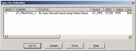

- The next step is to enter this command
AT_SPEC_SCAN
An attempt is made to process each component to fix its spec reference by matching its SYS_IDs in the spec. Since there is a component with a bad reference, this dialog is displayed:
Spec Fix Scan
Notice that the comp_id shown is the one in the message returned by running Update from Spec. The Go To button takes you to the component. The Update lets you update the spec record. After clicking Update, you see the same spec selection dialog as you do when placing a component that has multiple components matching the where clause. Select the correct one to update the component record correctly.
