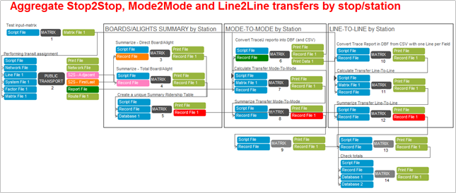

Matrix program #1 creates a “test matrix” with 100 trips between every OD pairs, and Public Transport program #2 undertake path building and loading (in one single program) with this “test matrix”.

The 1st task is achieved by post-processing and combining the information from the FILEO STOP2STOP output tables from a PT loading process, obtained with the following sub-keywords:

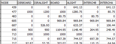

Matrix Program #3 calculates Direct Boarding and Direct Alighting Passengers at each stop node (first and last leg in the OD patterns) from the FirstLast report. Whilst Matrix Program #4 calculates the total Boarding and Alighting Passengers at each stop node from the Adjacent report.
Matrix Program #5 combine the 2 tables to obtain a summary table of Direct, Total and Transferring (Interchange) Boarding and Alighting for every stop node, as below:

The PT program #2 also creates the Report File (REPORTO) containing the TRACEI TRACEJ report for every pair of zones.
This Route Evaluation report is processed within Matrix Program #6 and Route Bundles are converted in DBF [and CSV] format.

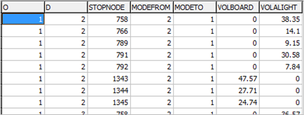

Assuming MODE<100 for TRANSITS and MODE>=100 for NON-TRANSIT modes, Matrix Programs #7 and #8 summarize this Route Bundles table to obtain Transit Mode-to-Mode transfers at each stop node.
The final table is the one below:

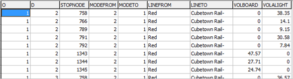

The CSV TRACEI and TRACEJ report, is processed within Matrix program #10, to create a DBF table containing the Lines information associated to each Transit Leg in the Route Bundle.
Matrix programs #11 and #12 finally summarize this information in an output table containing Transit Line-to-Line transfers at each stop node, as shown in the table below:
