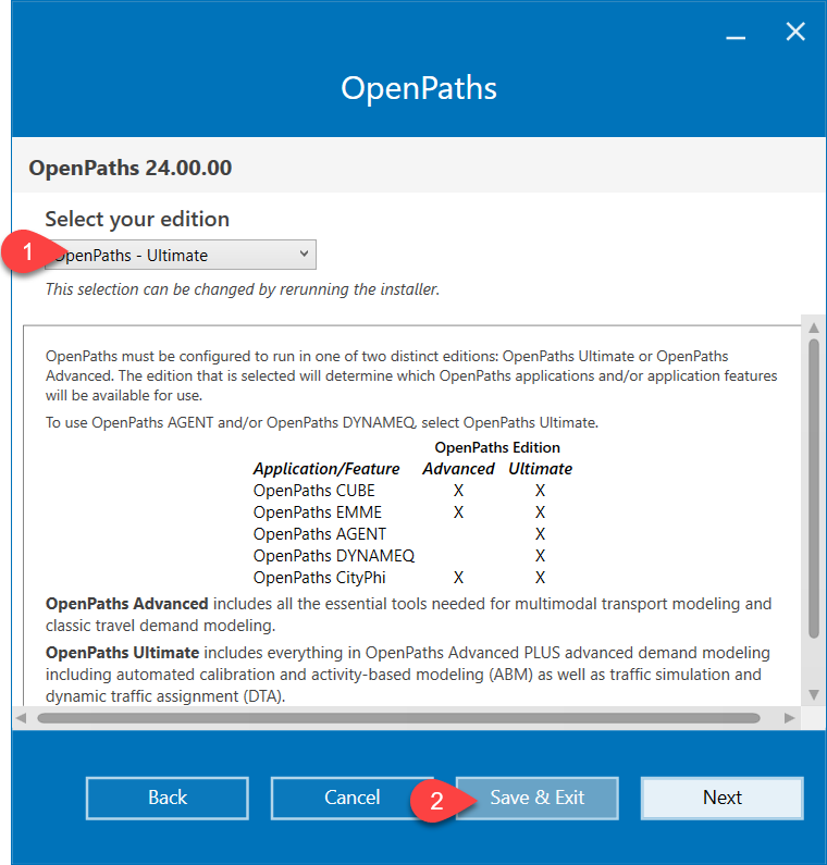

How to select OpenPaths edition (Advanced or Ultimate)?
After installation, to change OpenPaths editions, from Advanced to Ultimate or vice-versa:
  1. Rerun the downloaded OpenPaths installer.
  2. Click Modify and select the desired edition (1).
  3. Click Save & Exit to save the edition and quit the installer (2)
Note that changing OpenPaths editions will change your license level and may limit your access to the installed applications, depending on the edition selected. To ensure that all features and updates associated with your new license are properly applied, you must restart all running OpenPaths applications, including but not limited to CubeCacheServer, LegacyLicenseUtilty, etc.
It is suggested to save any unsaved work before proceeding with the restart to prevent any data loss.
It is not necessary to reinstall OpenPaths applications.
Which applications do OpenPaths editions permit?
OpenPaths is available in two editions: OpenPaths Advanced and OpenPaths Ultimate. The OpenPaths setup wizard will ask you to select which edition you wish to use. The following matrix shows the applications accessible with each edition. To use OpenPaths AGENT and OpenPaths DYNAMEQ, select OpenPaths Ultimate. OpenPaths EMME, OpenPaths CUBE and OpenPaths CityPhi are available with both OpenPaths Advanced and OpenPaths Ultimate.
