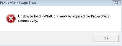

With Bentley View installed on the machine, following 'ProjectWise Login Error' is displayed on opening the document through Bentley Vision in a ProjectWise enabled AutoPLANT project:
Steps to Resolve
To avoid this:
  1. Kill the 'BPCom32Host.exe *32' from Task Manager.
  2. Next load the document through ProjectWise Explorer.
Once above is done, this issue will not reoccur.
Note: Removing Bentley View from the machine fixes the problem.
