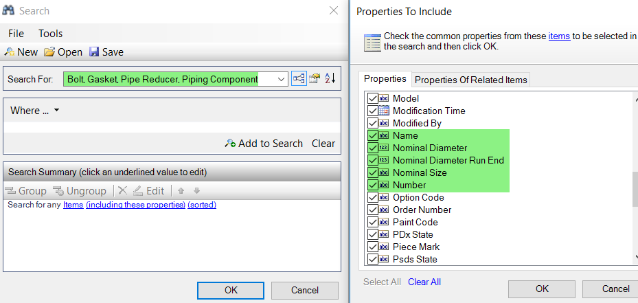

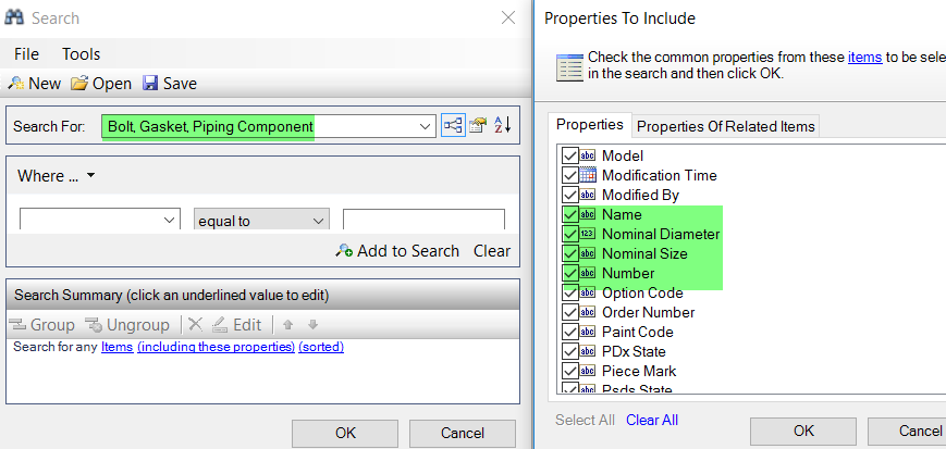

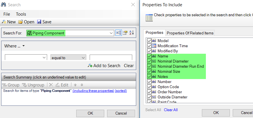

In OpenPlant Modeler, creating a report with multiple items doesn’t shows common properties. For example, if a user is creating report for Piping Component, it shows different properties list to be selected in report. However, if user creates a report with multiple types like (Bolt, Gasket, Piping Component), properties to be selected in report shows different properties list. Refer below images to have better understanding on it.
Report for Piping Component & its Properties list to be selected.
Notice that here we have property as Nominal Diameter Run End.
Report for Multiple Types of Items & its Properties list to be selected.
here, we don’t have Nominal Diameter Run End property to include & user want to add Nominal Diameter Run End

When report is created with multiple type of items, in properties to include only those properties will list that are common for the items. To append or include a property for multiple items, adding that property to missing items will fix the issue. Below wiki article will explain, how to show common properties in item report for multiple types of items/classes for OpenPlant Modeler report.

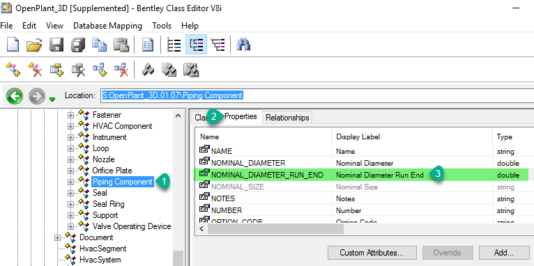

  1. Open OpenPlant_3D.01.07. ecschema using Bentley Class Editor.
  2. Supplement it with OpenPlant_3D_Supplemental_Modeling.01.07. ecschema & OpenPlant_3D_Supplemental_ModelingViews.01.07.ecschema
    For More information on supplementing schema click here>>>>

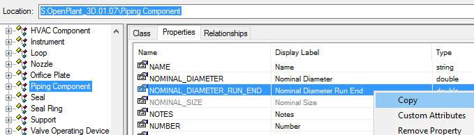

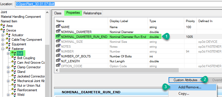

  3. Navigate to Piping Component class, switch to properties tab & search for “NOMINAL_DIAMETER_RUN_END” property. Refer below image.
  4. Right click on NOMINAL_DIAMETER_RUN_END property & from drop-down select Copy as shown below.

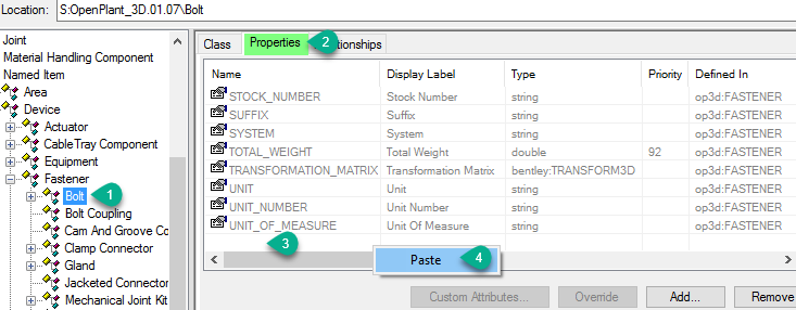

  5. Now, navigate to Bolt class, switch to properties tab.
  6. Scroll down in properties list, do right click & select paste. Refer below image.
  7. For Bolt class under properties tab, select NOMINAL_DIAMETER_RUN_END property.

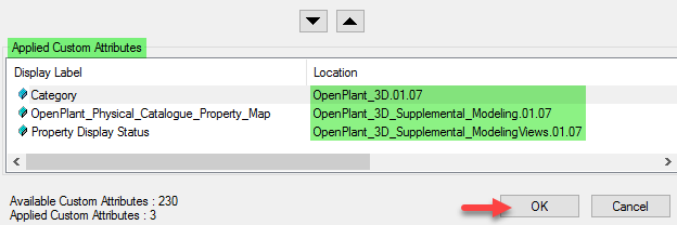

  8. Click on Custom Attributes > Add Remove, refer below image.
  9. Under Applied Custom Attributes Section, change schema locations & select OK as shown below.

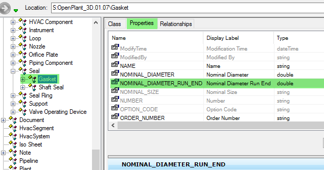

  10. Similarly, navigate to Gasket class.
  11. Switch to Properties tab scroll down & paste NOMINAL_DIAMETER_RUN_END property, as explained in step 8 for bolt class. Refer below image.
  12. Follow steps 9 & changes schema location of NOMINAL_DIAMETER_RUN_END property for Gasket class. Refer below image.

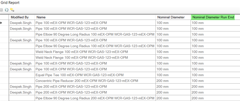

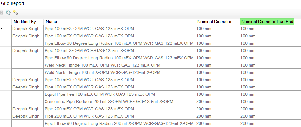

  14. Launch OpenPlant Modeler, create a new report with multiple type items & verify the result. Refer below image.
    As shown in above image, now we have same properties list for Piping Component item as well as for multiple items.  Create report
