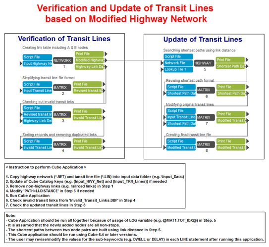

As shown in the below figure, Cube application includes two major processes as ‘Verification of Transit Lines’ (Step 1 – Step 4) and ‘Update of Transit Lines’ (Step 5 – Step 8), respectively. The user can disable either process by zeroing out the designated program modules if necessary.
The first process finds out any invalid links in transit lines while the second process updates these invalid transit links based on the shortest route information in highway network. The Cube Application is directly executed after copying both highway network file (.NET) and transit line file (.LIN) into the input data folder (e.g. \Input_Data), but the Cube Catalog keys below should be updated to indicate the correct file locations.

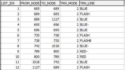

The first process of ‘Verification of Transit Lines’ outputs a list of invalid links (e.g. ‘\Base\Invalid_Transit_Links.DBF’) as below, and the second process of ‘Update of Transit Lines’ finally outputs the modified transit line files (e.g. ‘\Base \TransitLines_MOD.LIN’) that are updated using the shortest route data (e.g. ‘\Base\Shortest_Paths.CSV’) between the node pairs for invalid links.
