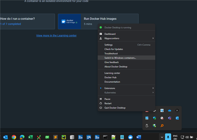

1. Install Docker in your machine. You can download and install Docker from the official website.
 2. Switch to Windows containers, by right-clicking on the docker icon as shown below:
