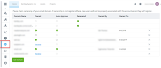

Claim your organization domain

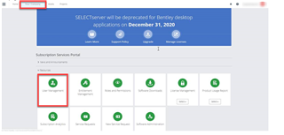

  1. Log into CONNECT portal and select your organization name on the top of the page. Inside your organization page, select User Management.
  2. In User Management, select Domains

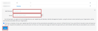

  3. Select Add Domain. Add the domain name, domain owner’s email and click Apply. An email will be sent to you to confirm the domain and complete the process.
Notes:  You can only add Private domains. Public domains such as gmail.com.com cannot be owned by an account.

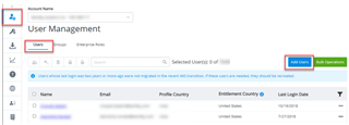

Add users
As an administrator of the account, you can add in other users from your organization..
  1. Inside your organization page, select User Management.
  2. On the Users and Groups screen, click Users tab and then click the Add Users button in the upper right corner.
  3. Complete the fields and click the Save button.

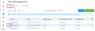

Assign roles
  1. On the User Management screen, click the Users tab and then select the user.

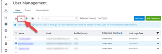

  2. Click the Assign Roles icon on the screen above user list.
  3. Select Roles from the list and click the Submit button. If you would like the user to download the installers for our products, please make sure that the 'Download' role is selected.
  4. Click on info icon to view brief description of the role.
  5. Put the tick mark against the desired roles to assign multiple roles to the user.
