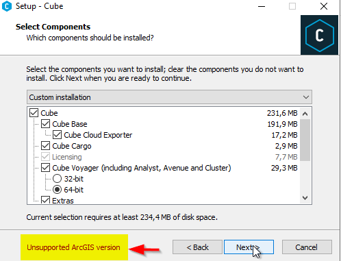

Before installing a new version of ArcGIS Desktop, you should uninstall CUBE and the ArcGIS Engine that came with it (if installed). If instead, you already installed a new version of ArcGIS Desktop with CUBE already installed, you should make sure to re-install CUBE on top of it.
If the installations are not compatible you should have seen a message like the below during the installation, then please upgrade the installation of CUBE or downgrade the one of ArcGIS (re-install ArcGIS first, then re-install CUBE).

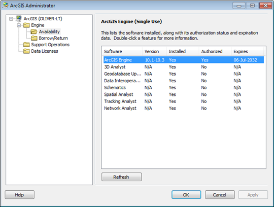

2.1. Check your ArcGIS administrator licence:
  1. Open ArcGIS Administrator and select ‘Availability’ under ‘Engine’
  2. Confirm ArcGIS Engine is installed, authorized and not expired.
