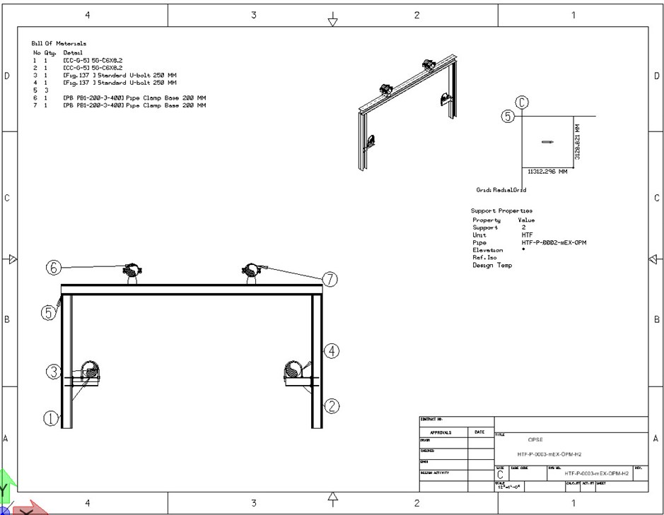

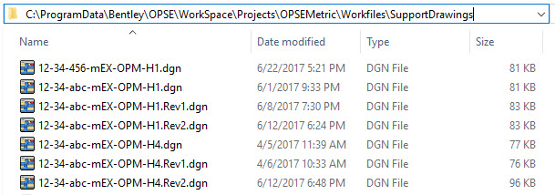

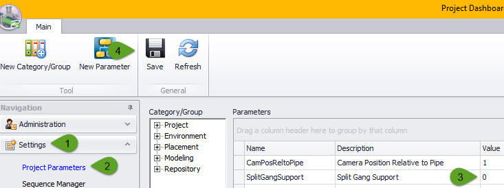

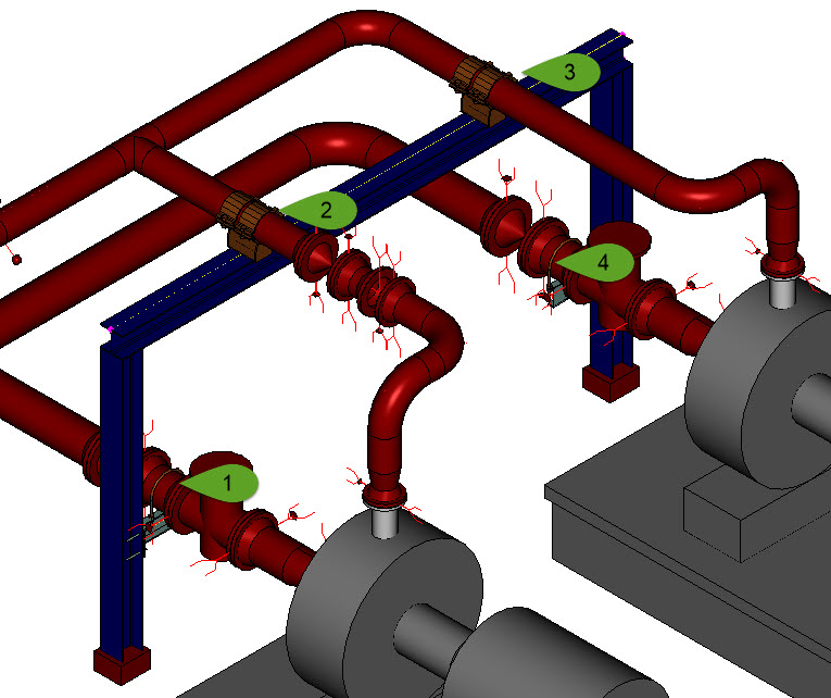

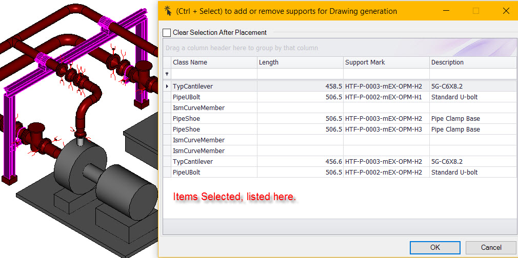

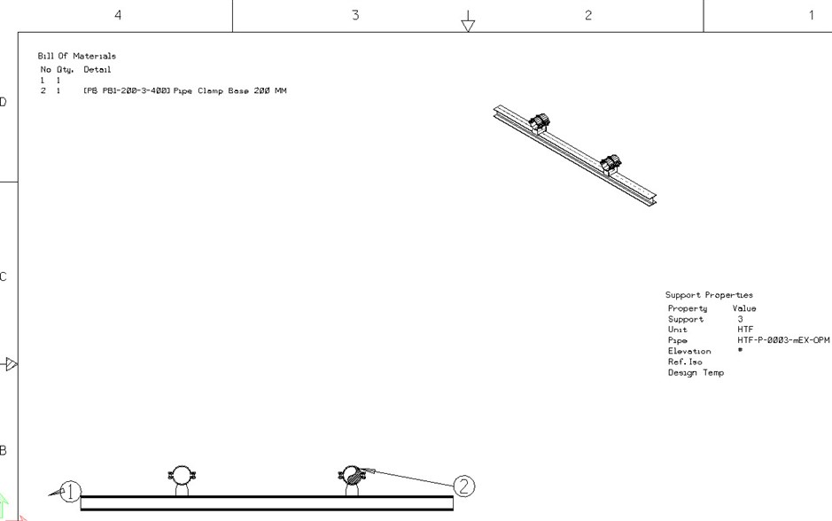

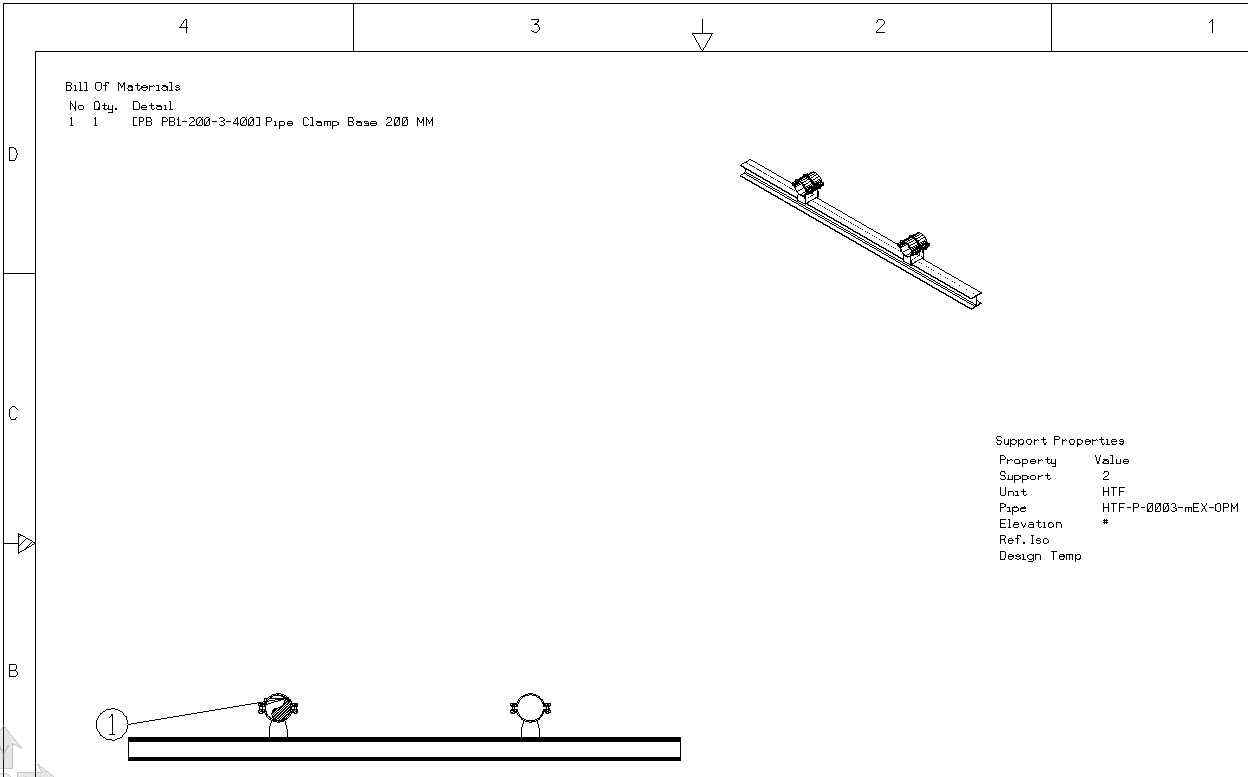

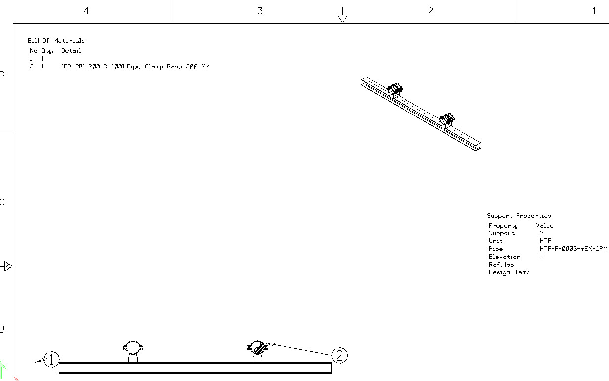

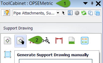

In OpenPlant Support Engineering, user requirement is to generate drawing for multiple supports at a time or can called as ganged support to generate in one single drawing. With latest release of OpenPlant support Engineering a new parameter SplitGangSupport has been added to the project parameter grid inside Project Dashboard which defines how a ganged support is detailed when support drawing(s) are generated or also having the separate drawings for each component. Below steps highlights both option used using variable SplitGangSupport.
When SplitGangSupport = 0
When SplitGangSupport = 1
