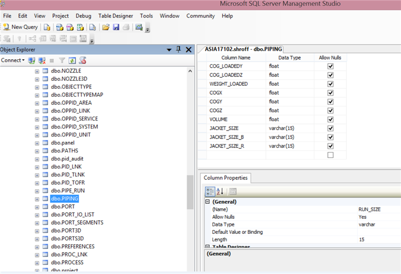

Add the new field to the Piping Table for SQL SERVER
8. After completing steps 1-5  Add your field to the Table.  The field Properties from most descriptive data can be set to match the Piece Mark field properties.
9. In the instance Microsoft SQL Server Management Studio is used edit the dbo.PIPING file to accomplish task.
10. Save and Close the Piping Table Design Session.
