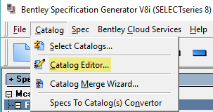

  3. Once the spec has been open go to Catalog>Catalog Editor.

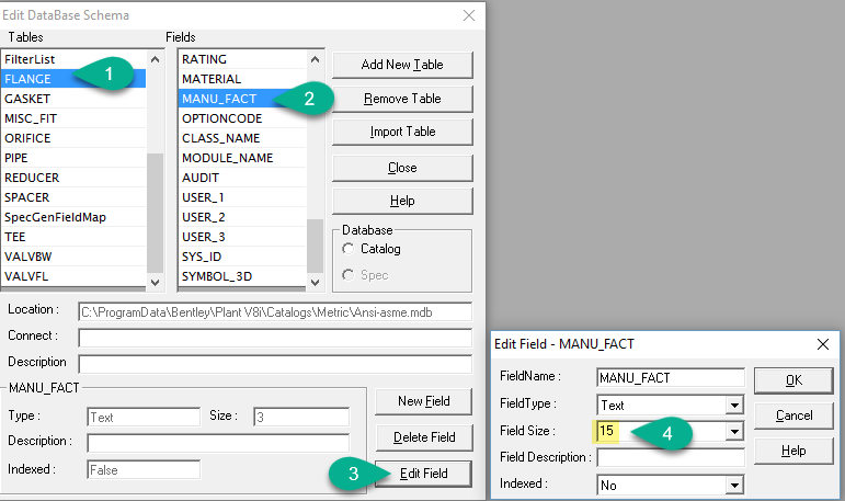

  5. In the Catalog Editor Edit > Edit Database schema.
  6. In the below dialog, select the desired Tables, Field and click on the Edit Field. This allows to change the Field Size. Set the field size to required length.

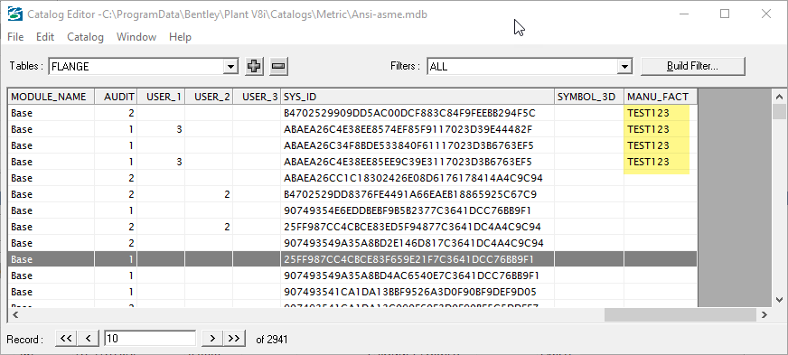

  7. Update the entries manually in the Catalog,
  8. Go to Catalog > Build Catalog.

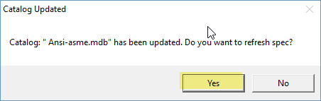

  9. Close the catalog editor. Specgen prompt  to update the spec click on Yes.

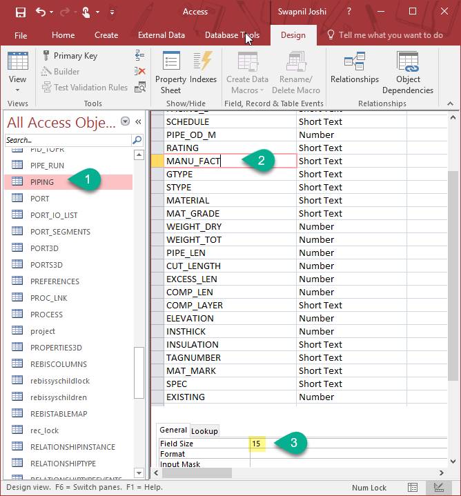

  11. Open the ProjData.mdb (ProjData.adb for SQL database) and open the PIPING table in the Design View.
  12. When the table is open in the Design View, select the field which is to be edited and change the Field size to the required length.

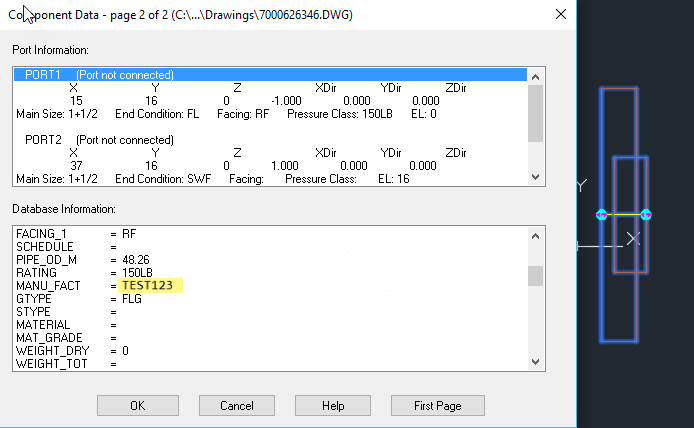

  13. Place the component in the AutoPLANT Modeler. Double click on the component and view the properties. The changes should get reflected here.
