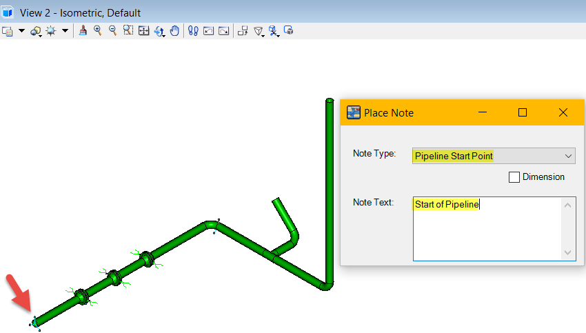

Introducing new tool in OpenPlant Modeler under “Place Note” option, which can control the order of Iso sheets generated in Pipeline Manager using, “AutoGenerate Iso-Sheet” option. To verify the result, generate Iso-Sheet with default setting through pipeline Manager using “AutoGenerate Iso-Sheet” option. Notice the Iso-Sheet assigned by default. See image below.
See below steps described in detail to re-order the Iso-sheet as per choice.
