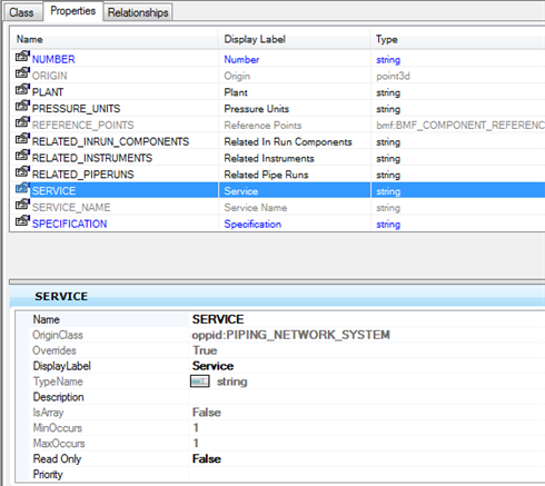

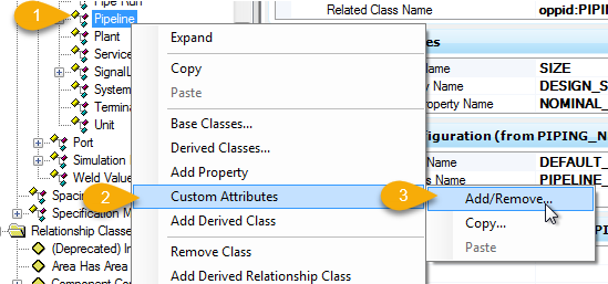

  4. Expand the tree in the left hand pane and pick on the PIPELINE class. Alternatively you can use the search tool to locate the class.
  5. Right click on the PIPELINE node in the left hand panel and from the context menu select Custom Attributes Add/Remove…

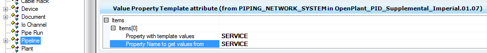

  6. Add the Value Property Template attribute and fill it in as shown below.

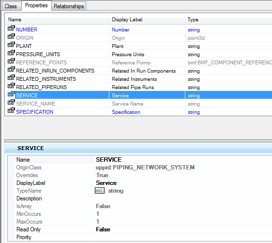

  7. Now switch to properties tab and scroll down and select SERVICE property.

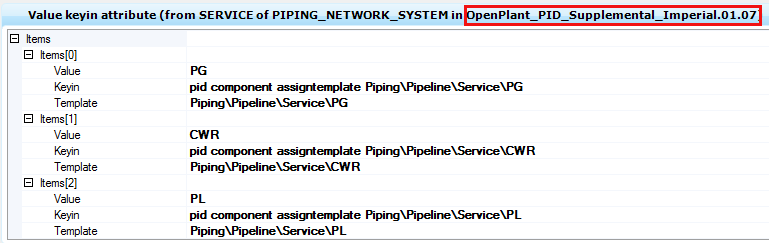

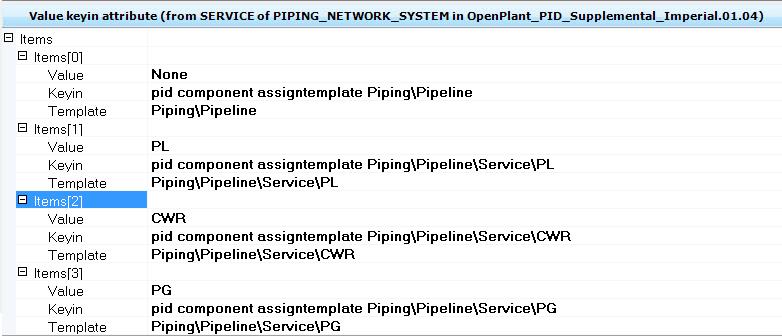

  8. Add the custom attribute Value Keyin Attribute and make sure to add this to supplemental schema and fill the values as shown below:
  9. Add the custom attribute Property Custom Attribute and make sure to add this to supplemental schema and fill the values as shown below:

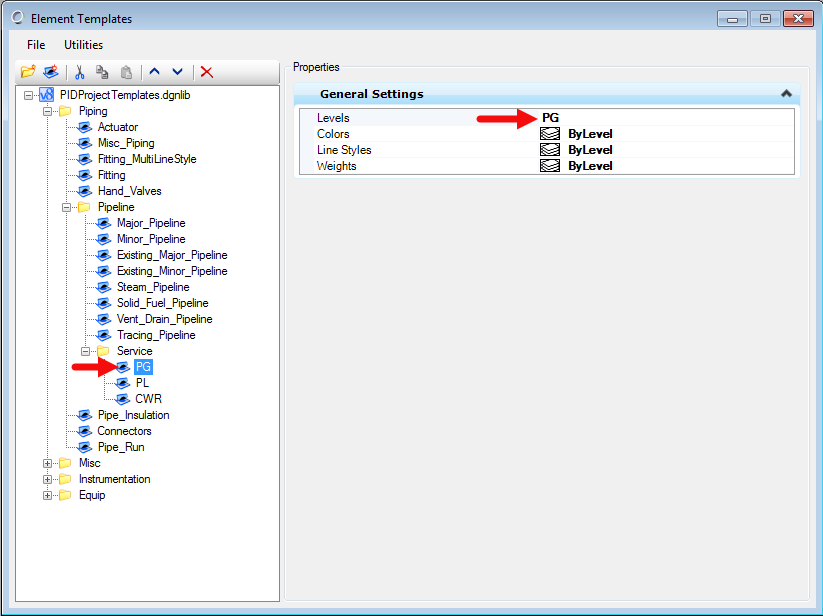

  1. Launch OPPID and open PIDProjectTemplates.dgnlib file.

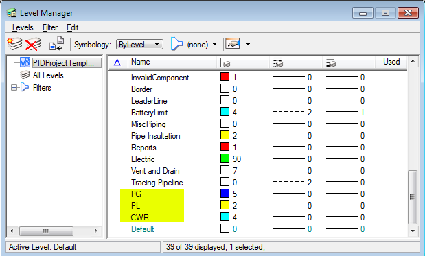

  2. Create the levels as per the names given in schema file.

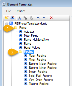

  3. Expand the tree and navigate to Piping\Pipeline Group.
  4. Right click on Pipeline and create a new Template Group and name it ‘SERVICE’.
  5. Right click on SERVICE group and create new templates and name them as shown below:

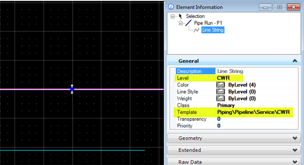

  1. Launch OpenPlant PID.
  2. Create a new PID file.

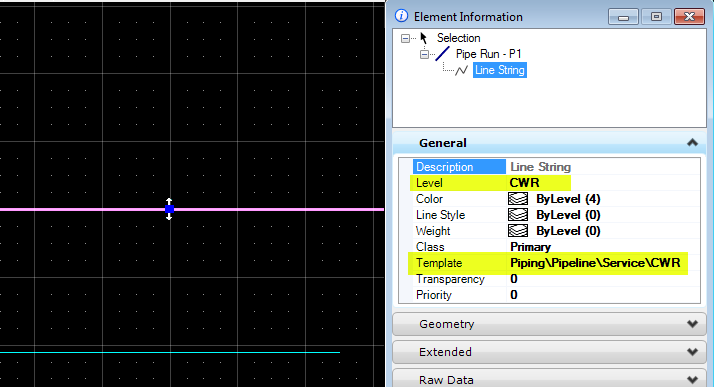

  3. Add three new services to the file. Add “PG”, “PL” and “CWR”.
  4. Place the pipelines with these services and verify the results. You will see the Level as well as color.
