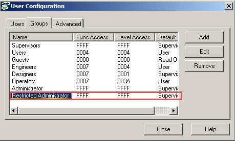

  1. Create Restricted Administrators group in Bentley Project Administrator.

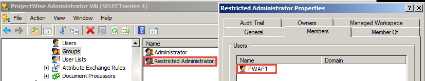

  2. Add required user to Restricted Administrators group in ProjectWise Administrator.

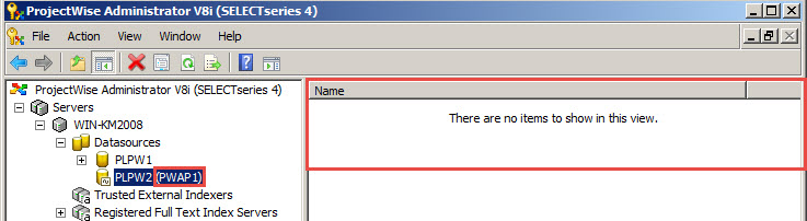

  3. Try to log in ProjectWise Administrator
    This user can log in to ProjectWise Administrator, but he has no rights to edit project settings and he can't do any changes for projects in ProjectWise Administrator. Administrator can grant him with rights to manage Datasource nodes and then he will see and will be able to change allowed settings.

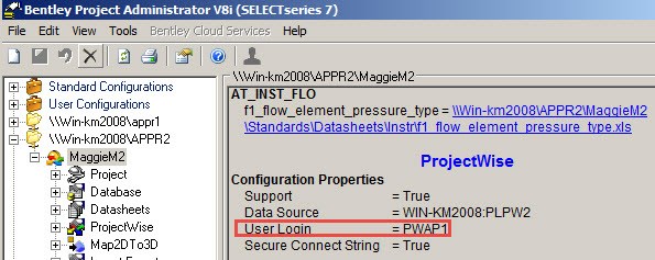

  4. Try to log in Bentley Project Administrator.
    This user is allowed connect to Bentley Project Administrator and edit all with ProjectWise integrated  AutoPLANT project settings. With ProjectWise Integrated AutoPLANT projects editing in Project Administrator is allowed only for Administrators and Restricted Administrators groups users.
